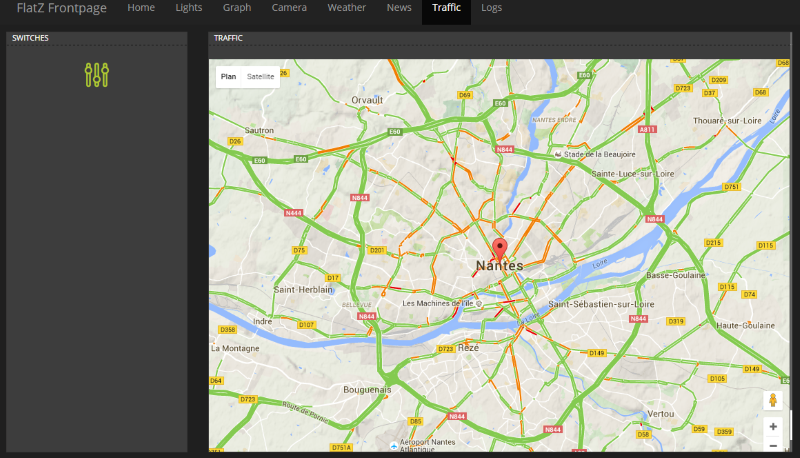

Hi guys,
Wonderfull ! i have a suggestion, could you add a traffic page based on google map ?
I added a new traffic.html page with
Most difficult is to add correct javascript. It can be useful !
Thk
<script>
if ($.Traffic)
{document.write('<li class="active" ><a class="stay" href="traffic.html"><i class="icon-th icon-white"></i> Traffic</a></li>');}
</script>Thk

Re: FlatZ Frontpage
I do it, not most beautiful coding but it works !
<!-- DONUT CHART -->
<div class="col-sm-3 col-lg-3" style="width:75%;float: right">
<div class="dash-unit " style="height:610px;overflow-y:scroll">
<dtitle>Traffic</dtitle>
<hr>
<!--<div class="info-user" style="float:right;padding-right:20px;">
<span aria-hidden="true" class="li_news fs2"></span>
</div>-->
<p id="map" style="width:100%; height:100%"></p>
</div>
</div>
</div>
<!-- /row -->
</div>
<!-- /container -->
<script src="http://maps.googleapis.com/maps/api/js?sensor=false"></script>
<script type="text/javascript" charset="utf-8">
var address = 'Nantes, FR';
var map = new google.maps.Map(document.getElementById('map'), {
mapTypeId: google.maps.MapTypeId.TERRAIN,
zoom: 12
var trafficLayer = new google.maps.TrafficLayer();
trafficLayer.setMap(map);
var geocoder = new google.maps.Geocoder();
geocoder.geocode({
'address': address
function(results, status) {
if(status == google.maps.GeocoderStatus.OK) {
new google.maps.Marker({
position: results[0].geometry.location,
map: map
map.setCenter(results[0].geometry.location);
else {
// Google couldn't geocode this request. Handle appropriately.
</script>- jec_44
- Posts: 7
- Joined: Wednesday 14 January 2015 16:21
- Location: Nantes France
Re: FlatZ Frontpage
See the result
- Traffic Page
- FlatZ Frontpage - Traffic.png (376.23 KiB) Viewed 5416 times
- galadril
- Posts: 857
- Joined: Monday 07 September 2015 10:32
- Domoticz version: latest
Re: FlatZ Frontpage
Looks goodjec_44 wrote:See the result

Re: FlatZ Frontpage
galadril, i'am lokking for integrate it into settings.js to be able to enter parameters :
bu i 'don't how to do and how to use it on traffic.html
$.traffic = "Paris, France";
$.zoom = "15";Thanks

Re: FlatZ Frontpage
Thanks for the help.jec_44 wrote:but i 'don't how to do and how to use it on traffic.html
I've added the Traffic page to the github project with two new settings in the settings.js
