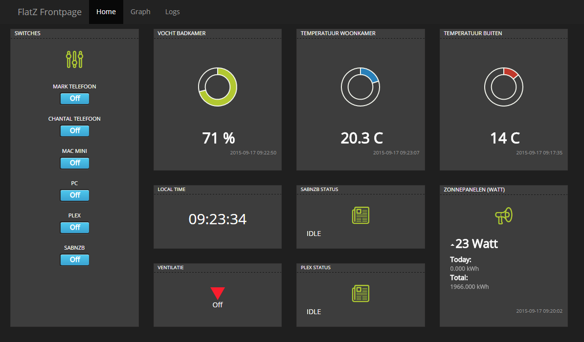

:roll: Version 0.2
Please let me know if you like it and what should be added/changed??
- Upload all files to the www directory
- Adjust user settings in settings/settings.js: the URL of your domoticz, the idx and names of your switches and devices
- Open in browser [your Domoticz IP:port]/frontpage.html
Credits to Hansbit, I've used his frontpage to rework for my own!

Screenshots:

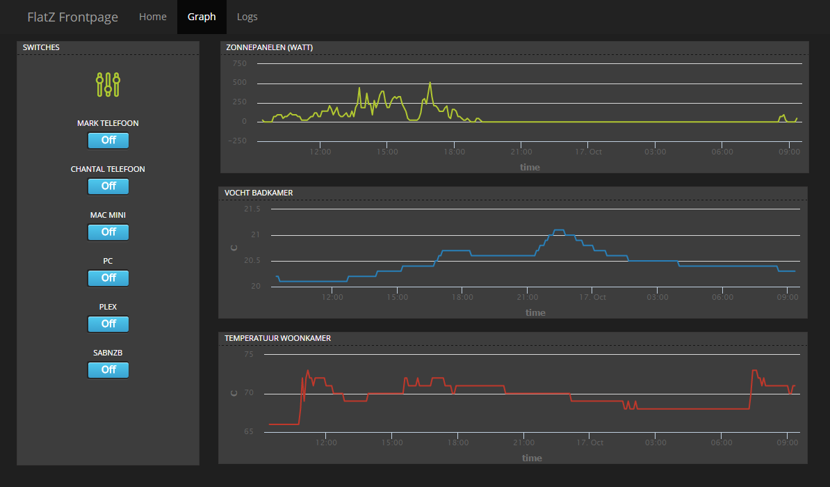

I found the json calls and now also have graphs in the dashboard..

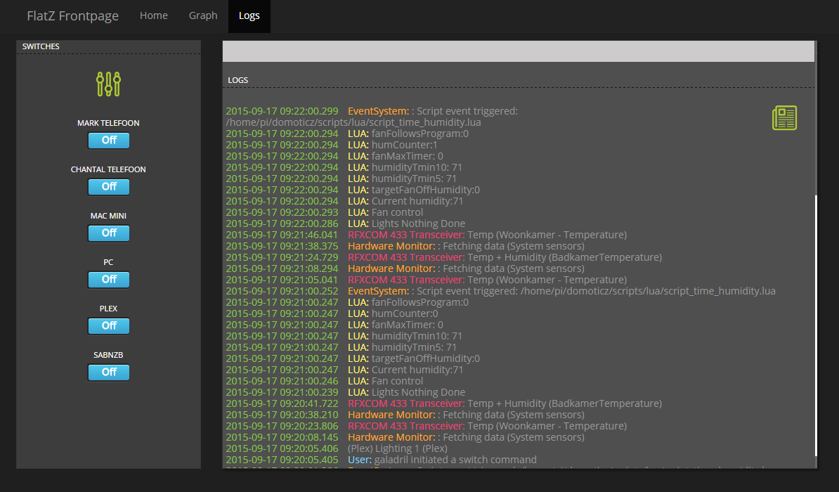

Progress update:
- Graph screen
- Logs screen (+filter input)
see screenshots, hope you like it..
