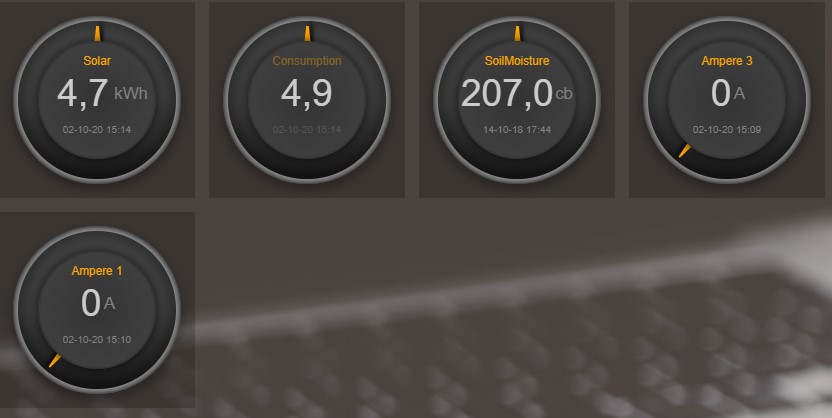

Wow, that looks great, I will give it a try this weekend! Thanks!`
Do other types work as well? Watt, KWh? I've still empty slots....
Dashticz Watt:
blocks['379_1'] = {
  width: 4,
  type: 'dial',
Dashticz KWh:
blocks['379_2'] = {
  width: 4,
  type: 'dial',
Domoticz:
Idx 	Hardware ID		Unit	Name	Type	SubType	Data
379	Panelen	00082379	1	GroWatt	General	kWh	2.700 kW
Lokonli
Posts: 2296
Re: Dashticz Dial - Features, Fixes & Updates
Post by Lokonli »
Bochelork wrote: Friday 02 October 2020 11:42 Wow, that looks great, I will give it a try this weekend! Thanks!`
Dashticz Watt:
blocks['379_1'] = {
  width: 4,
  type: 'dial',
Dashticz KWh:
blocks['379_2'] = {
  width: 4,
  type: 'dial',
Domoticz:
blocks[6] = {
    type:'dial',
    values: ['CounterToday'],
    showunit: true
blocks[46] = {
    type:'dial',
    showunit: false
blocks[636] = {
    type:'dial',
    showunit: true
blocks[1027] = {
    type:'dial',
    showunit: true
blocks[1028] = {
    type:'dial',
    showunit: true
columns[2] = {}
columns[2] = {
    blocks: [
        6, 46, 636, 1027, 1028
    width: 6
