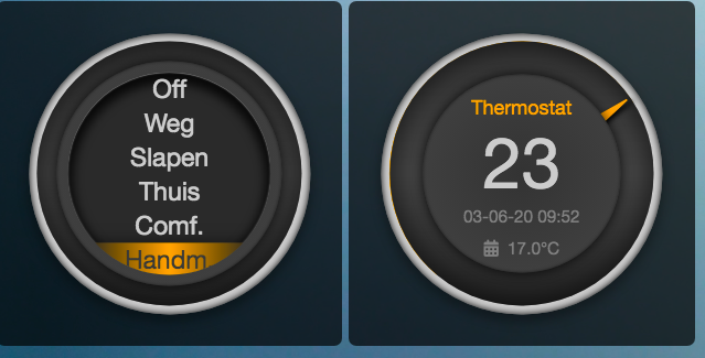

I like how this is now for the Toon. :) I've got Toon setup with dummy-devices already, so it should work (I hope)
Screen Shot 2020-06-03 at 09.55.49.png (190.13 KiB) Viewed 9581 times

EdwinK wrote: Wednesday 03 June 2020 9:14 I like how this is now for the Toon. :)
Great, glad you like it :D

EdwinK wrote: Wednesday 03 June 2020 9:14 I like how this is now for the Toon. :) I've got Toon setup with dummy-devices already, so it should work (I hope)
Nice one, I made this one too In my system, but.
Is it possible to hide the OFF?
This is also hidden in the Domticz switch.

gielie wrote: Friday 05 June 2020 18:45
You can try adding this to your custom.css, replacing it with your block name.
[data-id='_BLOCK_NAME_'] .dial-menu li:nth-child(1){
   display: none;
gielie
Posts: 290
Domoticz version: latest β
Re: Dashticz Dial - Features, Fixes & Updates
Post by gielie »
clinkadink wrote: Friday 05 June 2020 19:10
   display: none;
my code would be this
[data-id='Toon2'] .dial-menu li:nth-child(1){
   display: none;
but this has no effect
   display: none;
Works for me.
   display: none;
Works for me.
Yeah for me too now, had an curly bracket too much
But now, How do I get an temp/hum sensor in the dial button and is it possible to get an degree icon and an decimal in the dial?

gielie wrote: Friday 05 June 2020 22:52 How do I get an temp/hum sensor in the dial button and is it possible to get an degree icon and an decimal in the dial?
Like this?

I am currently expanding the support for the dial component. I am currently working on adding:
"Type" : "Temp + Humidity"
"Type" : "Temp + Humidity + Baro"
Are there anymore that would suit the dial? I cannot promise I can accommodate, but I will try.
Obviously, if most of you ask for the same device to be added, then that gets prioritised ;)
