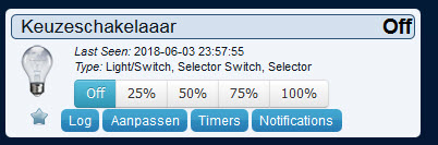

Dashtitcz beta 2.3.5
Selection switch display fault.
should be..
regards
Frank
should be..
regards
Frank
- domoticz_Keuzeschakelaar.jpg (29.92 KiB) Viewed 7513 times

To fix this (until a new release) is to edit main.jsyfands wrote: Thursday 07 June 2018 11:45 Dashtitcz beta 2.3.5
regards
Frank
I modified js/main.js and js/main.custom (I'm not sure if both are needed), I also noticed the same files under vendor/js/ can anyone comment on if these are used or not?
Change
var names = device['LevelNames'].split('|');
To
var names = atob(device['LevelNames']).split('|');

In main.js I changedLokonli wrote: Thursday 07 June 2018 12:56
A PR for the first issue has been created already. Probably will be merged with the new beta soon. I'll try to find a clean solution for the second issue as well. (without you having to relocate)
tovar names = device['LevelNames'].split('|');
then it worked. I have latest beta of domoticz I dont know if it work with erlier verisons of domoticz.var names = atob(device['LevelNames']).split('|');

This is fixed in the latest beta.EdwinK wrote: Thursday 07 June 2018 13:19To fix this (until a new release) is to edit main.jsyfands wrote: Thursday 07 June 2018 11:45 Dashtitcz beta 2.3.5
regards
Frank
Change
To

I think we are missing an image..
but regarding the switch selector there is a fix, I modified js/main.js and js/main.custom (I'm not sure if both are needed)?
Change
To
regards
Frank
