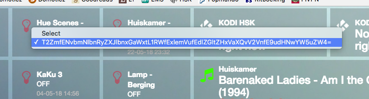

Not sure if this is Dashticz or Domoticz
Screen Shot 2018-05-23 at 17.30.47.png (150 KiB) Viewed 5784 times

EdwinK wrote: Wednesday 23 May 2018 17:32 Not sure if this is Dashticz or Domoticz
I am seeing the same thing, looking at the json for the affected switches and Levelnames and Levelactions are all garbage, my guess is it is linked to this commit.
https://github.com/domoticz/domoticz/co ... 04db3d9dd0
Wob76
Posts: 110
Joined: Wednesday 19 April 2017 6:31
Re: Dashticz - Bug report
Post by Wob76 »
A fix for the above, The Levelnames are now being base64 encoded.
I modified js/main.js and js/main.custom (I'm not sure if both are needed), I also noticed the same files under vendor/js/ can anyone comment on if these are used or not?
Change
var names = device['LevelNames'].split('|');
To
var names = atob(device['LevelNames']).split('|');
