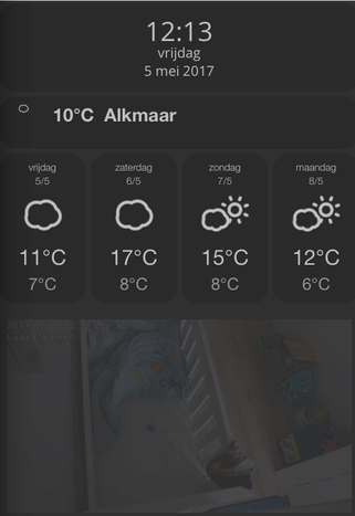

I have added my camera to the standby screen and i can see the camera but its kind of greyed out so not very clear.
- Aeotec MultiSensor 6
- FIBARO FGS223
- FIBARO FGWPE Wall Plug
- Neo CoolCam Power plug
- Popp Smoke Detector
- Toon
- Kodi Media Server
htilburgs
Posts: 464
Re: Dashticz - Bug report
Post by htilburgs »
That is the meaning of the standby-screen ;)
This is as designed.

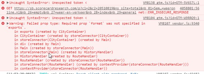

I debugged it again on my laptop and it appeared to be an external site with a invalid script, 99% of the time the dashboard hangs has something to do with an external site. Maybe there are possibilities to make it more independent from external site or some sort of error handdling when a script error occurs on a external site.
htilburgs
Posts: 464
Post by htilburgs »
Like to share which external site / script??
Hardware:
Blueone
Posts: 130
Joined: Friday 29 November 2013 11:30
Post by Blueone »
Sometimes like nu.nl or weeronline. Or some errors in one of the vendor scripts:
2017-05-06 11_53_47-Developer Tools - 10.100.10.3_8080_dashboard_index.html.png
2017-05-06 11_53_47-Developer Tools - 10.100.10.3_8080_dashboard_index.html.png (38.83 KiB) Viewed 26992 times
Most of the times is goes oke, but sometimes he browser stops responding after a long period.

DewGew wrote:In latetest master, selector switch is not working on my dashbord then also 'weather' and 'currentweather_big' is not showing any icons in stand by when using new moving icons.
// DewGew
I add screenshot..there is no icons after last update with new moving icons any ideas???

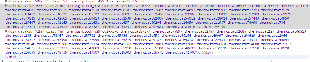

There appear to be a new bug with the thermostat function. Every 5 seconds (the refresh time) there is a class added to the thermostat setpoint. When you increase or decrease the setpoint the action is done for every added class, zo if you have the dashboard open for a couple of minutes the classed several dozens of classes are added to the setpoint, and it is going to change the setpoint for every class and one click will change the setpoint with 10 degrees for example:
robgeerts
Posts: 1273
Domoticz version: 3.7067
Post by robgeerts »
Blueone wrote:There appear to be a new bug with the thermostat function. Every 5 seconds (the refresh time) there is a class added to the thermostat setpoint. When you increase or decrease the setpoint the action is done for every added class, zo if you have the dashboard open for a couple of minutes the classed several dozens of classes are added to the setpoint, and it is going to change the setpoint for every class and one click will change the setpoint with 10 degrees for example:
Please test in latest beta!
// DewGew
Just tested and seens to work here..
