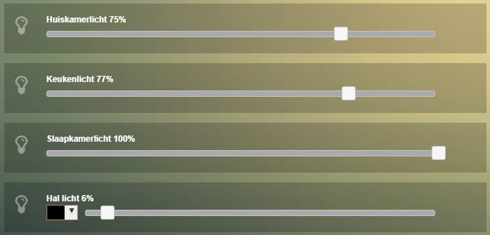

I noticed RGB support only seems to work for Milight bulbs with type RGBW in Domoticz.
Type RGBWW (v6 of the protocol) does not give me a color selector switch in Dashticz.
'Hal licht' is the only RGBW bulb I have, the others are a RGBWW (v6) type.
EDIT: Fixed by Rob now!
- milightdashticz.jpg (32.4 KiB) Viewed 4347 times

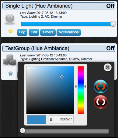

I also experience the issue of having a RGB selector for a Hue group containing only ambiance (RGBWW) lights. I guess there is an issue with Domoticz not choosing the correct type as domoticz says the group is RGBW instead of RGBWW. A single light from the group doesn't get the RGB selector.
The slider is functional in dashticz. But the color selector is not useful and I'd like to get rid of it.
I also added commented on this issue here: https://github.com/domoticz/domoticz/issues/1202 I hope it can be in Domoticz itself. But for now, is there a workaround to hide it from dashticz?
