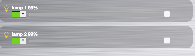

Screen Shot 2017-07-13 at 16.25.20.png (69.9 KiB) Viewed 4186 times
Although the lights do change to different colours, the icon only shows one colour for both devices
