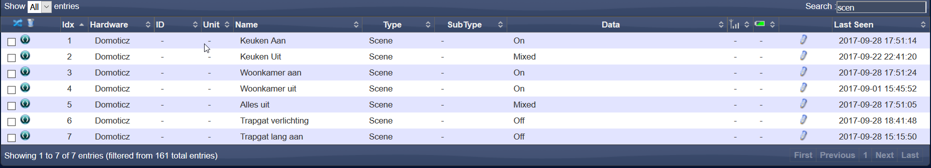

I'm quite new to Domoticz and to dashticz. At this moment I am creating a dashticz dashboard and I run into an issue when I try to switch a scene (Alles uit).
The button does not appear in the screen, while other blocks (lamps and a power meter) do work.
I tried all of the following settings:
var blocks = {}
blocks['s5'] = {} //Alles uit
blocks['s5']['width'] = 6;
blocks['5'] = {} //Alles uit
blocks['5']['width'] = 6;
blocks[5] = {} //Alles uit
blocks[5]['width'] = 6;
var columns = {}
columns[4] = {}
columns[4]['blocks'] = ['s5',5,s5]
columns[4]['width'] =4;
var screens = {}
screens[1] = {}
screens[1]['background'] = 'bg2.jpg';
screens[1]['columns'] = [4]
None of the tried options is working. I also read that
should be the right one.
If I look into domoticz the IDX of my scene is 5.
2017-09-28 18_56_16-Domoticz.png (56.87 KiB) Viewed 3399 times
If I just use the the url
http://x.x.x.x:x/json.htm?type=command&param=switchscene&idx=5&switchcmd=On
all my lights do go off as expected.
What am I doing wrong?

CaesarPL
Posts: 104
Joined: Tuesday 08 November 2016 14:03
Location: Poland
Post by CaesarPL »
In my case this one works fine
var blocks = {}
blocks['s1'] = {}
blocks['s1']['width'] = 4
columns[1] = {}
columns[1]['blocks'] = ['blocktitle_1',24,100,103,21,22,166,'s1'];
columns[1]['width'] = 6;
screens[2] = {}
screens[2]['columns'] = [1,7,9];
Are you sure that you have switched auto positioning to Off?
Stephan83
Posts: 11
Joined: Thursday 28 September 2017 18:39
Post by Stephan83 »
That was indeed the trick! Auto positioning was turned on :oops: .
Thanks for the verry quick response!
