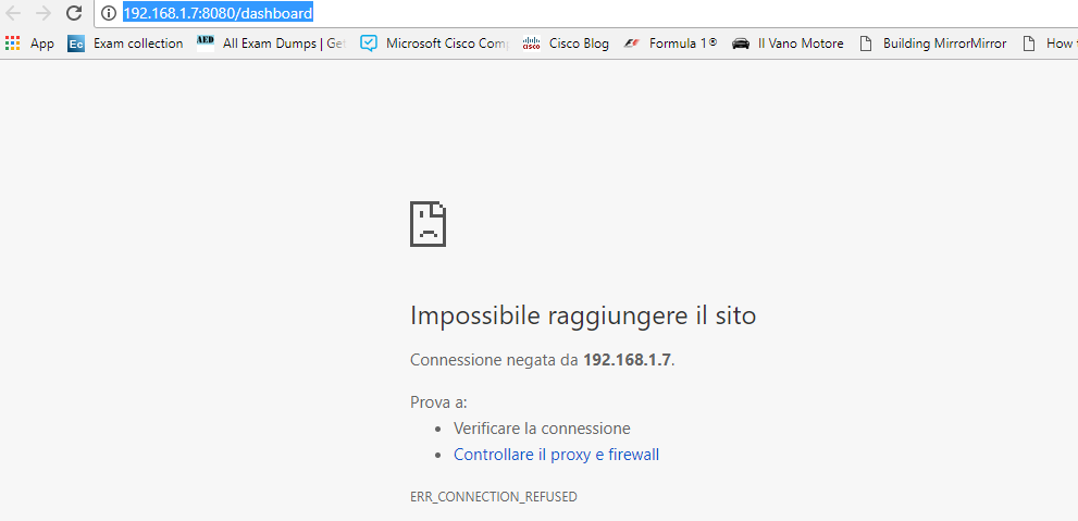

Why have I problem?

corederoma82 wrote:Why have I problem?
Either the ipaddress 192.168.1.7 is not reachable, or port 8080 is not reachable..
corederoma82
Posts: 85
Joined: Saturday 14 January 2017 21:34
Post by corederoma82 »
but the ip addrees and port are corrects.....
