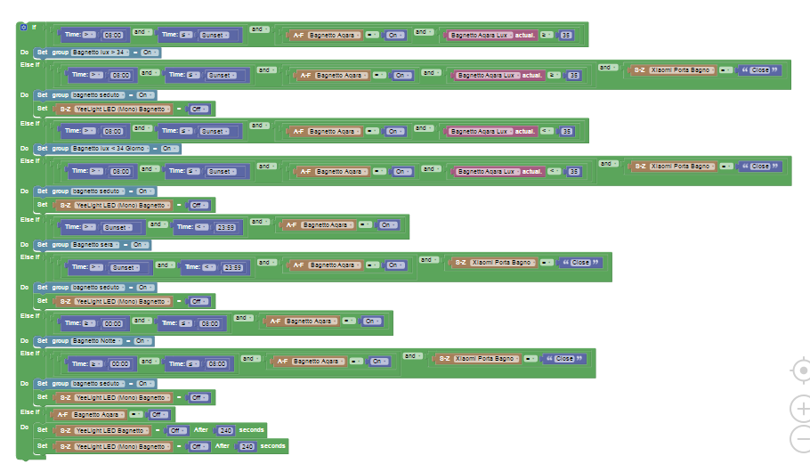

yes i try but o don't know if the variable is off when the door is close or "close"
- Catturablock.PNG (89.01 KiB) Viewed 3662 times

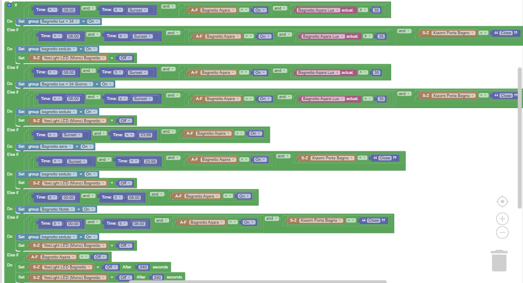

hy thank youchatainsim wrote: Tuesday 05 September 2017 15:39Events -> Lua, device:matteos1 wrote: Monday 04 September 2017 22:01 i'de like to create a scene where when i close a door with xiaomi door sensor one light is on and when the door is open light is off.
how i can i make it possible??
thank youCode: Select all
commandArray = {} if (devicechanged['Door'] == 'Closed' and otherdevices['Xiaomi RGB Gateway'] == 'Off') then commandArray['Xiaomi RGB Gateway']='On' elseif (devicechanged['Door'] == 'Open' and otherdevices['Xiaomi RGB Gateway'] == 'On') then commandArray['Xiaomi RGB Gateway']='Off' end return commandArray
could see this picture and transform in lua?

chatainsim wrote: Tuesday 05 September 2017 17:14It's too small to read text.matteos1 wrote: Tuesday 05 September 2017 16:38hy thank youchatainsim wrote: Tuesday 05 September 2017 15:39
Events -> Lua, device:Code: Select all

why don't you try to translate to lua then ask for help if you are stuck ?matteos1 wrote: Tuesday 05 September 2017 19:18 Cattura.PNG
i think is better
hy thank you

It's not because I don't want to help, It's because it's the best way you to learn lua
I'
Yes i know but only this timechatainsim wrote:It's not because I don't want to help, It's because it's the best way you to learn lua

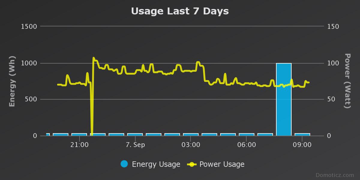

I just added a few zigbee power sockets to my setup, they are working fine and reporting power, on my utility graph I only see power usage and energy usage, apart from an odd "spike" on energy usage it seems to report "0", is anyone else experiencing this?
I just did a test with it set to "computed" and I now see results in the "Energy Usage", is it possible to have these devices set to computed when they are created by the plugin?
