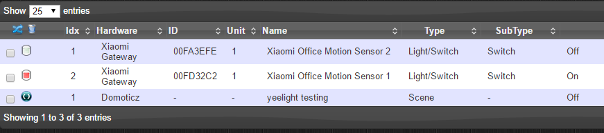

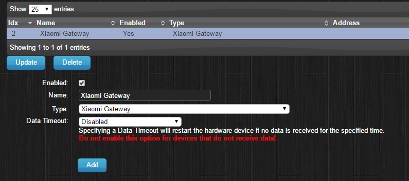

Xiaomi Gateway with motion sensors working in Domoticz
- devices1.PNG (22.81 KiB) Viewed 55022 times
- hardware1.PNG (73.39 KiB) Viewed 55022 times
deennoo
- Posts: 784
- Location: Bordeaux France
Great !!! What about communication speed ?
Does your motion sensor is update as faster than the gateway ?
