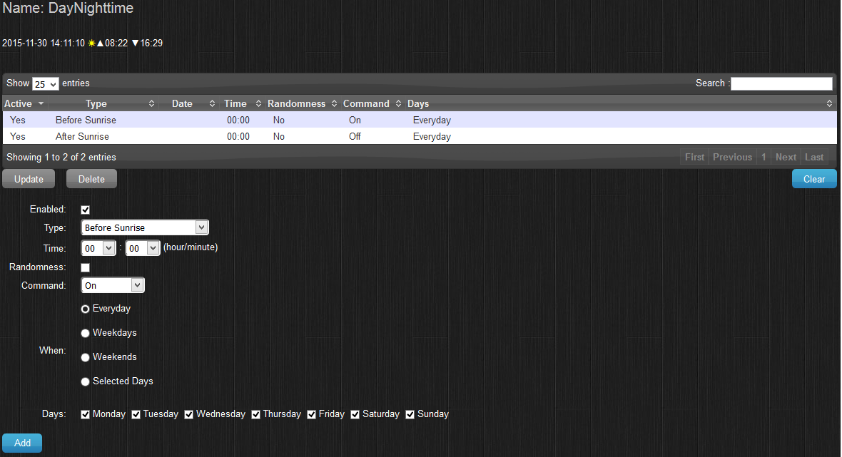

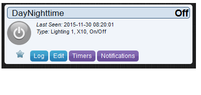

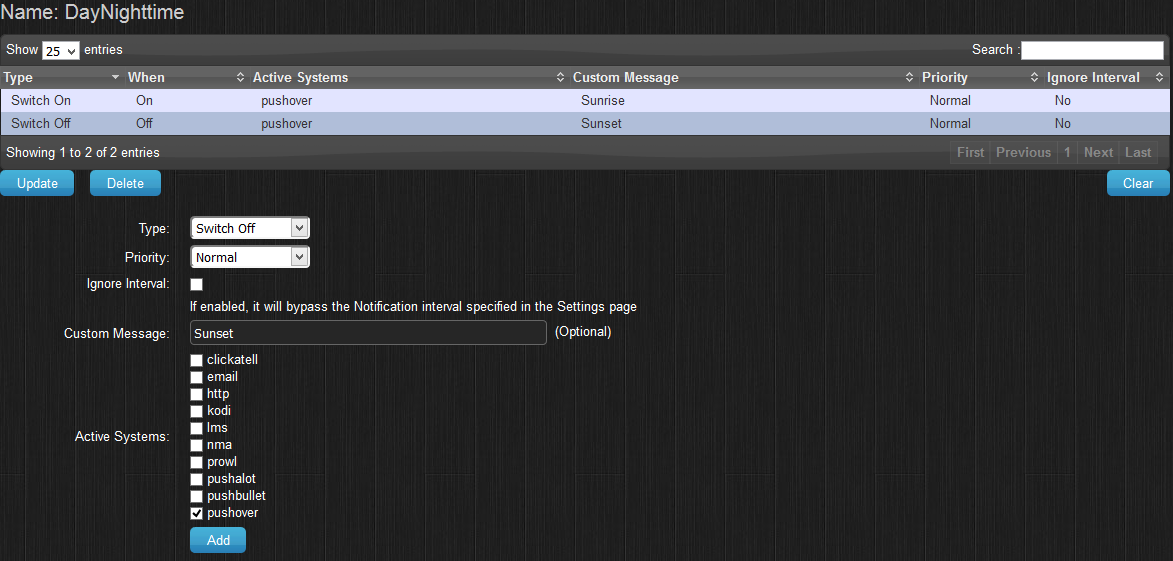

For later (serious) use, I wanted to play first with a 'day / night time switch'. I created the switch with the name DayNighttime (picture 1) and created two notifications with it via pushover (picture 2). This morning with sunrise, I got two messages, instead of the expected one message (picture 3). Please help me understand why Domoticz thinks sun is set and sun is risen. Thank you.

You're right! Here's a screenshot.bbqkees wrote:You have omitted how you set the timers.

Re: The use of daytime switch (sunset / sunrise)
So zero minutes before sunRISE you set it to on, and zero minutes after sunRISE you turn it to off.
This is the same moment, you want to turn it off at sunSET.
Ah... thanx a lot! Now I understand. cheers!bbqkees wrote:So zero minutes before sunRISE you set it to on, and zero minutes after sunRISE you turn it to off.
