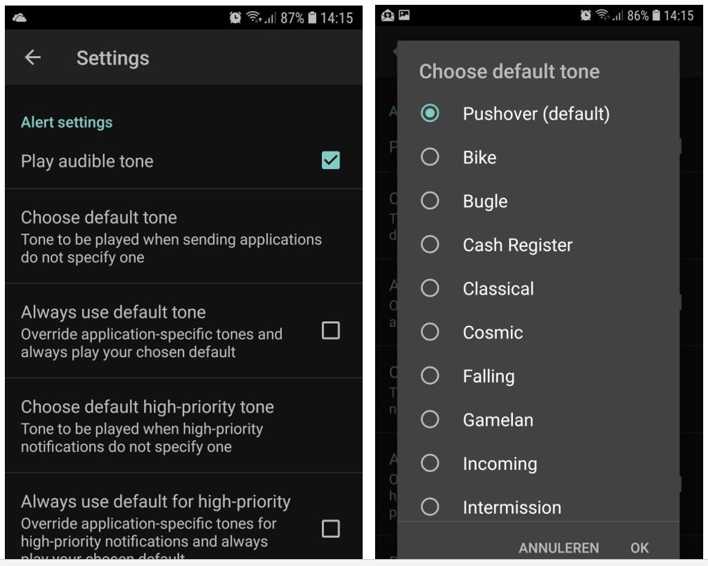

Is "Always use default tone" unchecked on the Pushover app?

Yes it is unchecked

Try to set two different sounds in the app, not stock sounds, (one for normal level and one for alarm) and try to see If Domoticz works well. Don't forget to check "Always use the default tone".
If It works, then go back, uncheck "Always use the default tone" and test If different stock sounds are correctly played with Domoticz.

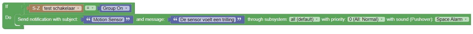

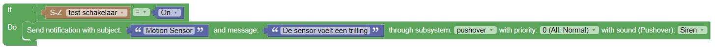

Hi, Same problem here.
No matter what i tried, I alway get the default tone (Even tried with a dummy switch): Played a lot with settings in App, but cant solve the problem. What am i doing wrong?

Strange, but in case i choose:
Through subsystem "all", than the sound choice works.
But Through subsystem "pushover" I alway get the default sound and sound choice plays alway default sound, no matter what i choose.
Ofcourse I do not want to send it to all subsystems! Only to pushover.
