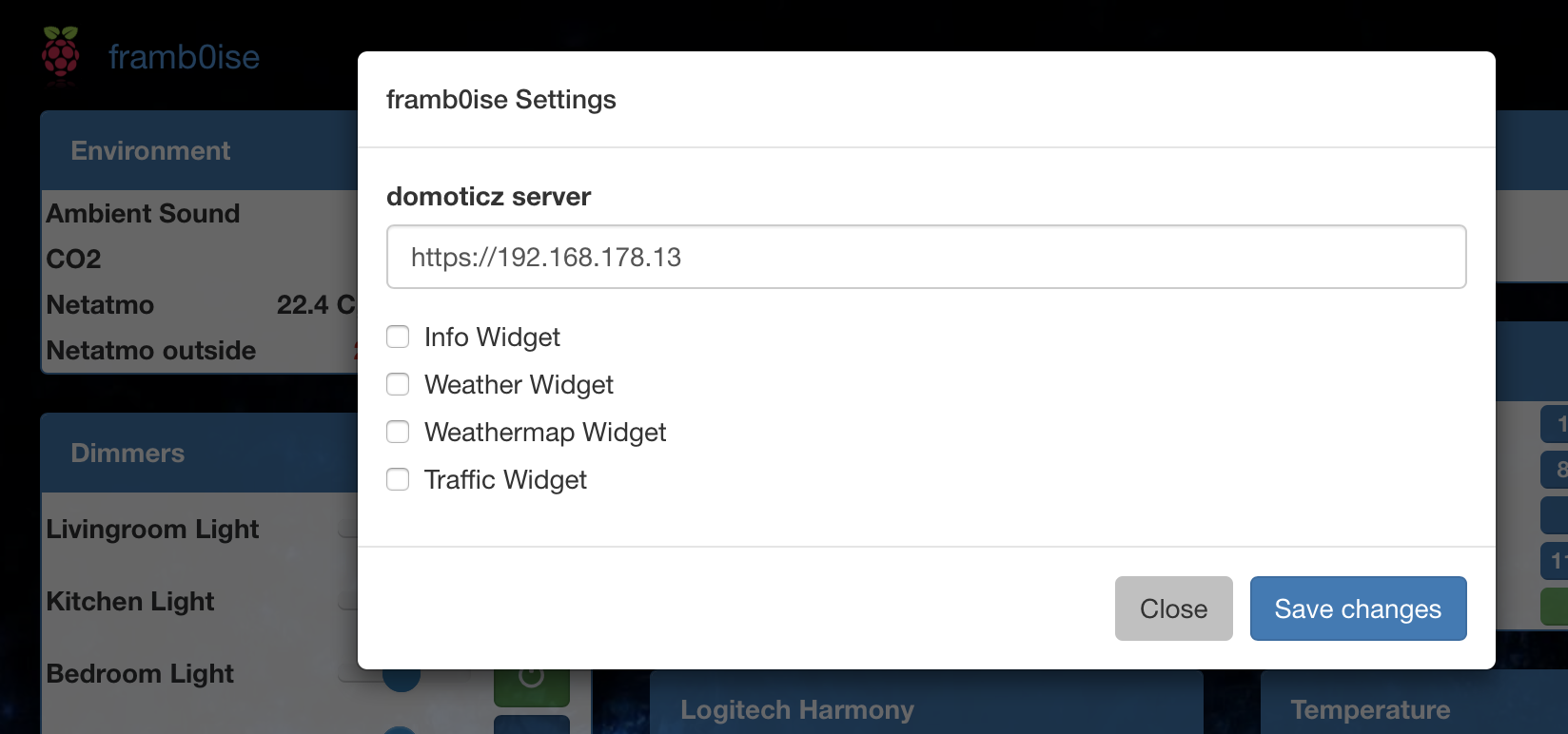

No prob. But we don't both don't have blinds inverted. Could you send a json file of that device? Then we can implement it for you?tontze wrote: Yes im sry, i got impression that it was allready added after jvdz presented code for it

No more config.js

@tontze ,
Am I correct to assume that this blind doesn't have an percentage option, but merely UP/DOWN ( and possibly STOP)?

Sounds great, but you do realize that this setup is using one single static setup at this moment, so it can either be the internal or external port.marcotrumpet wrote:jvdz wrote:marcotrumpet wrote:Hi
Yes I did. But the domoticz local port and the external one I use eith ddns are different. If I set in config "http://ddns:domoticzinternalport" or "http://ddns:domoticzexternalport" nothing appen
EDIT
My bad.. using "http://ddns:externalport" work!thanks mate
Maybe we should simply use the original URL's ip:port.

yes. with the new settings window your settings will be stored for future updates.Maikie wrote:For my information, updating just by cloning from git again with this command?
git clone https://github.com/safi78/framb0ise

All stuff is stored in 'local storage'. very safe and secure, only YOUR browser can access this, nothing is accessible for others or send over.qwerk wrote:nicely done, where does framboise store the password?
and the thicks?
It's like a very permanent cookie
