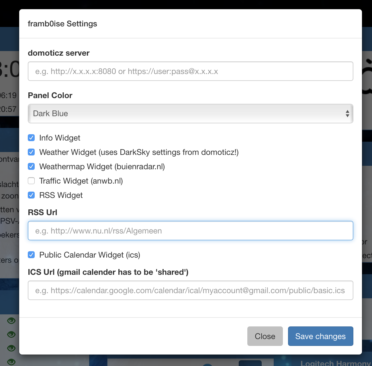

ZERO CONFIG, a config window will popup after installation:
Settings will be saved between updates!

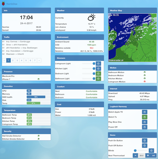

Install was very easy and it looks great.safi78 wrote:It's very usable now, any comments are welcome ofcourse
all my items are shown, that is a great plus and also a great minus.
I have to rethink my roomplans ( which was long over due) And it shows all my "temporarily" test devices, that is nice.
It also shows some devices double. Light in the living room is also on the first floor, so twice in Framb0ise.
My first impression is really good.
When a dimmer is turned off, ( off and still at 60%) in Framb0is you can't tell if it is on or off.
keep up the good work

Hi qwerk,
Thanks for your feedback
Couple of thoughts:
I haven't even thought of 'floors' yet, have to dive into that. Background is, that I'm a very heavy domoticz user, but never really find a use for the room-plans, so I decided to base it on that. I will look into that shortly
On the dimmers: I run this on an iPad mini on my wall and want this to keep it as tiny as possible. So, adding the slider functionality came with a feature (or bug) wich I thought was pretty nice: when you slide all the way up to '0', the light is turned 'Off' but the slider goes back to the original 'Level'. That worked for me, but could be confusing for others.
I'm really going for a 0-config, 100% usable approach, so functionality is added with a microscope
Thanks for you reply, very useful.
Is this something you will would be likely to use as an addition / dashboard?
Kind regards.
Couple of thoughts:
Kind regards.

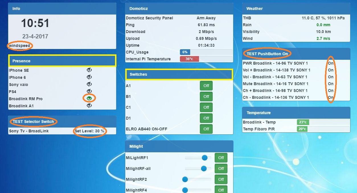

Hello

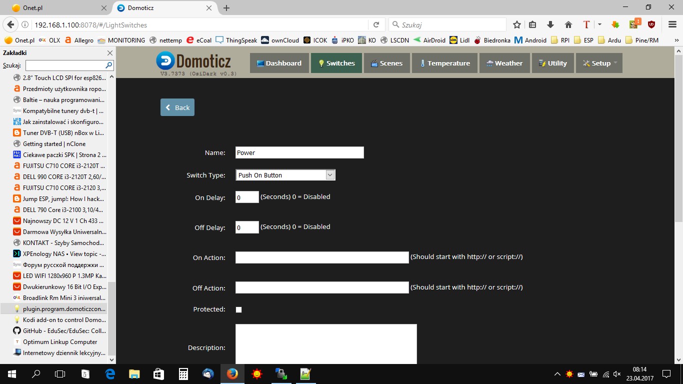

I'm using the Broadlink plugin
https://www.domoticz.com/forum/viewtopi ... 79#p125879
Switches on Broadlink are PushButton On
I can see them in framb0ise but I can not switch them
Could it be fixed?
One more thing.
In my opinion, buttocks should be the other way round.
Button (On) should be Green
Button (Off) should be red

First of all, thank you for your work.
I'm not good at programming, but I made the installation very easy.
I have some questions:
1. How can I delete "windspeed" from Info tab? I have not changed anything.
2. Can you add contour rectangle? As you can see the color of the title is confused in some places with the background.
3. Can the color of "Presence" devices change? Not very visible (device present).
4. A button (settings) can be added to the page to change:
- Upload new background
- change rectangle color
It does not work for me - Selector switch and PushButton.
Thank you in advance for your answer.
- Clipboard02.jpg (167.5 KiB) Viewed 20165 times

Hi guys, good feedback, I like!
First of all, the windspeed is added IF a Darksky device is found. Because I try to get information directly with the Darksky-api I have to use a CORS-proxy, in this case, https://crossorigin.me. The ssl-certificate of that service expired yesterday, therefore requests are 'blocked'. The windspeed (and all other Darksky stuff) is then added to the layout, but left empty. I already send the developer of crossorigin.me an email to fix his certificate (and promised I'll buy him a coffee if he does
As temporary work-around you could 'accept' the faulty certificate in your browser (just browse to https://crossorigin.me and accept the certificate permanently) but I don't recommend that.
If you want to reverse the On/Off classes, take a look at how this is handled in framb0ise.js, it's not very difficult to change.
2. It's probably better to find yourself a better background? (/img/bg.jpg) OR change the opacity in frambo0se.css:
3. What do you suggest? Make it the same as Motion?
4. Good idea!
I'll add the 'PushButton On' in a minutekniazio wrote:Switches on Broadlink are PushButton On
Could it be fixed?
1. See my first remark on the crossorigin.me. As temporary work-around you could 'accept' the faulty certificate in your browser (just browse to https://crossorigin.me and accept the certificate permanently) but I don't recommend that.andi216 wrote: 1. How can I delete "windspeed" from Info tab? I have not changed anything.
.panel{
opacity: 0.9;
4. Good idea!
