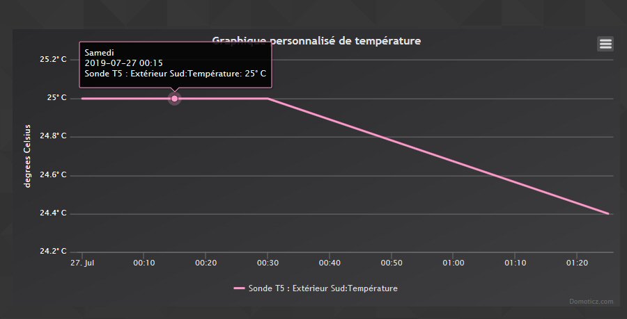

I had ton unplug/plug the Wifi Zigate in order to make the things working again.
Durring that moment, my sensors were recorded but with exacly the same tempreture enven if it was decreasing. I have a plot every 5 minutes between 00:00 and 00:30 (all on the same horrizontal line). After I don't have any data until 01h25 (line going down).
Erreur temperature.jpg (36.12 KiB) Viewed 1589 times

keros wrote:Hello twoenter, hello pipiche, hello all !!
I'm facing the same issue, that's why I reply to this topic.
In my case, the Zigate using USB is working fine. But with Wifi, it's more complicated : I can loose my Aqara sensor informations after a few hours.
I brought the Zigate last month.I reflashed the wifi module this afternoon.
This is an exemple of my log this evening :
2019-07-27 00:00:01.868 Status: Starting automatic database backup procedure...
2019-07-27 00:00:05.971 Status: Ending automatic database backup procedure...
2019-07-27 00:02:33.490 Status: (Zigate) onDisconnect called
2019-07-27 00:23:28.173 Error: (Zigate) retreiveTimeOut_Motion - Database error: database disk image is malformed
2019-07-27 00:23:28.174 Error: (Zigate) 'onHeartbeat' failed 'TypeError':'unorderable types: NoneType() > int()'.
2019-07-27 00:23:28.176 Error: (Zigate) ----> Line 737 in '/home/pi/domoticz/plugins/Domoticz-Zigate/plugin.py', function onHeartbeat
2019-07-27 00:23:28.176 Error: (Zigate) ----> Line 600 in '/home/pi/domoticz/plugins/Domoticz-Zigate/plugin.py', function onHeartbeat
2019-07-27 00:23:28.176 Error: (Zigate) ----> Line 1327 in '/home/pi/domoticz/plugins/Domoticz-Zigate/Modules/domoticz.py', function ResetDevice
Note : the access to the zigate admin web page is very long, even unreachable some times (have to plug and un plug).
Note also : if I do not select I select /dev/serial0 as serial port, the raspberry pi will start to reboot and reboot without ending. I had to unplug the power to be able to restart normaly and have time to go to the seetings and found that /dev/serial0 was the good one for the Wifi model.
I'm trying right now without the automatic updates of the database. I'll keep you updated.
Which version/branch of the plugin are you using ? Indeed there is is a relation with the auto-backup of domoticz

keros
Posts: 77
Joined: Saturday 27 July 2019 0:39
Re: Compatibility Zigate and Synology nas
Post by keros »
I didn't recevied after the moment I switched to beta.
When I came back, after lunch, I wasn't able to reach the zigate web admin page. I unpluged/repluged it.
I just did a git pull, a restart, and now the data are slowly comming back (wating for the dashboard update).
I had some troubles with the zigate wifi since the begining for me (15th june) so I set the plugin debug to Domoticz Plugin.
