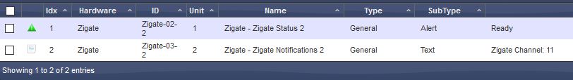

Re: Compatibility Zigate and Synology nas
Success!!!
So basically this issue was that I used Domoticz package without Python. Then I uninstalled this verion and Python 3 package too what was a mistake. This is why Domoticz+Python package failed to start. After installing Python 3 package Domoticz started. Plugin installation was also successfull. I added Zigate and what I see now in HW list is:
What are these two devices? I'm sorry for the silly questions but I'm poor beginner.
- Posts: 7029
- Domoticz version: 2026.3
Those are 2 devices that hi you information about the ZiGate device itself. See also the plugin admin widgets page in the plug-in wiki https://github.com/pipiche38/Domoticz-Z ... ng/Home.md
Excellent news !Johnny5 wrote: Thursday 13 June 2019 22:22 Success!!!
And indeed, @waltervl is right those 2 widgets are createdby the plugin to give you some information. We are currently on a Web Administration page for the plugin which then will be replacing those
