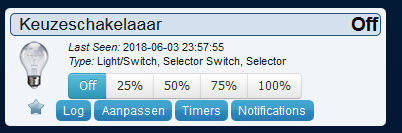

Hi All,
i have a problem with a switch selector and Dasthicz.
have those lines in my switch selector:
In Dashticz i see this:
and not the list in first image.
Does someone know what this can be?

I think we are missing an image..
but regarding the switch selector there is a fix, I modified js/main.js and js/main.custom (I'm not sure if both are needed)?
Change
var names = device['LevelNames'].split('|');
To
var names = atob(device['LevelNames']).split('|');
regards

This is fixed in the latest beta
Thanks. I will test this or update to latest with git pull
