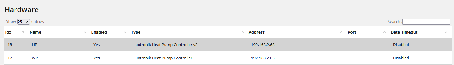

You can run them side by side, as long as you give the new plugin hardware a different name to the old one Also the new topic is located here: viewtopic.php?t=44176JaapB wrote: Monday 08 December 2025 17:04Thank you for putting in this effort.Ragdag wrote: Tuesday 02 December 2025 19:51Have not forgotten about you, am busy figuring out a proper way of doing this.JaapB wrote: Sunday 19 October 2025 12:12

- Ragdag
- Posts: 169
- Joined: Friday 30 March 2018 13:56
Re: Python Plugin: Luxtronik Heat Pump Controller Plugin for Domoticz
I'm not a Heat pump expert
The 8888 port is not a web port that responds.
Have you tried the new plugin (viewtopic.php?t=44176) if it works?
