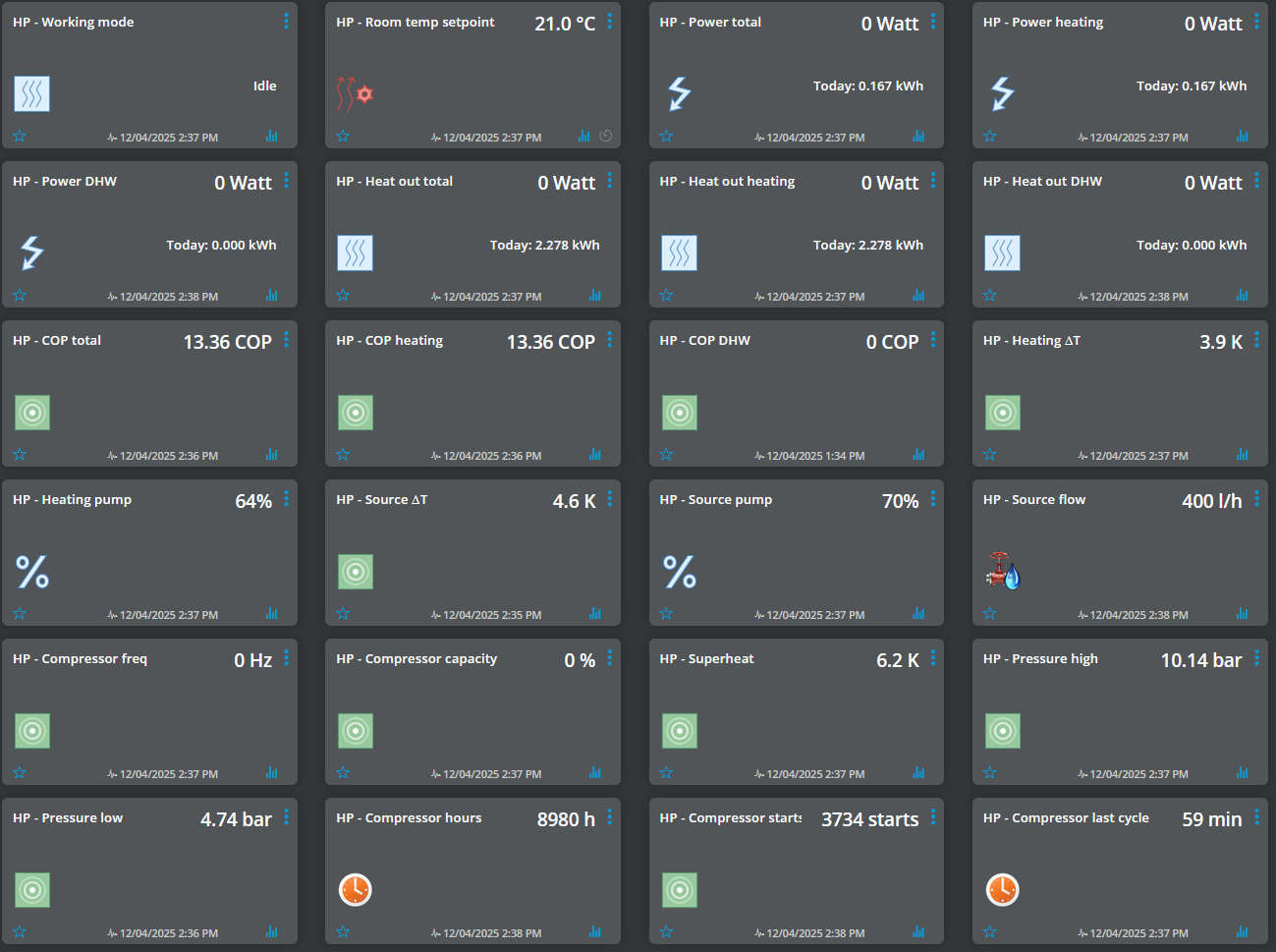

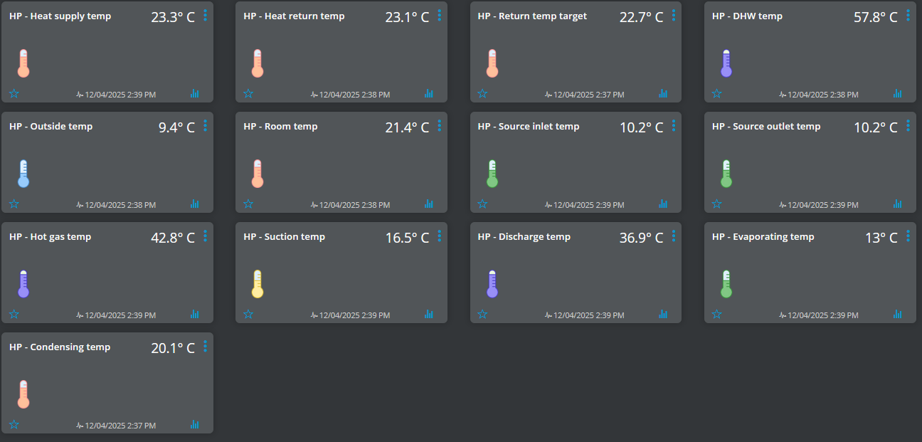

Screenshots
Utility devices (power, energy, COP)
Temperature sensors
