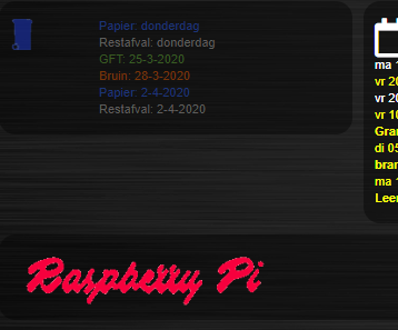

Today i encounterd something strange,
I was looking at the garbage settings and i noted when i change "config['garbage_use_colors'] = 0;" that the colors of everything are less bright
And when i use the "config['garbage_use_names'] = 0;" then it makes of the blue PMD the name "papier" while it is PMD
garbage 2.png (33.08 KiB) Viewed 2152 times
I use ophaalkalender.be as provider.
Latest beta from Dashticz & Domoticz
Pics are a bit bigger so you can see the "brightness" of the other items
