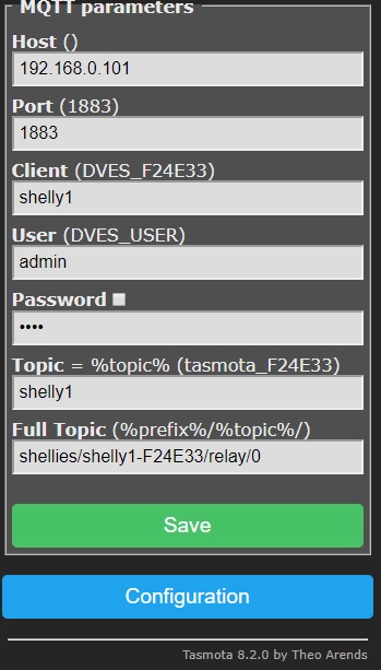

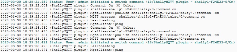

Hello guys,
I'm trying to get it work, I have a Shelly 1 V3, successfully installed and started the Shelly plugin.
Problem is that I cannot make it work the on/off switch from domoticz to the shelly 1 relay, I'm attaching the configuration of tasmota flashed firmware on my shelly 1 and the logs result when I tried to switch on the mqtt switch created itself by domoticz.
Thank you in advance and stay safe

Re: Python Plugin: Shelly MQTT
Hello
The Shelly plugin requires the original soft Shelly.
If you have Tasmota, this is only the mqtt broker but without the Shelly plugin
Thank you very much besix, I didn't understood that It was only for the stock shelly firmware.besix wrote: Monday 30 March 2020 19:41 Hello
I have now successfully started the MQTT Client Gateway and I am now controlling the shelly1 relay!
Thanks!!!

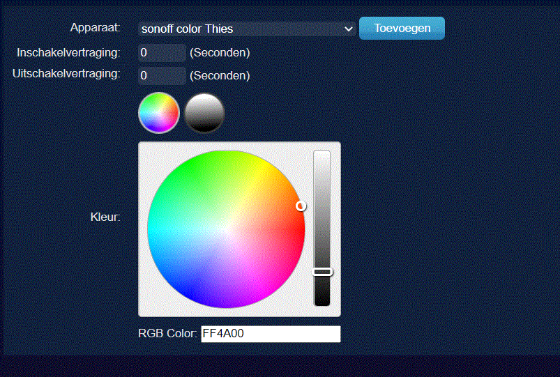

I don't know if i'm posting it on the right place here, but i want to control my RGBW2 Shelly device with automatic color change.
i want to setup a sunrise color which flow over to daylight and at a specifick time to sunset and then to moonlight.
I have tried to set it with dzvents, but i don't know the right codes to set the colors let alone how to set it at different times and how to gradient
i want to use it for my aquarium lights.
can anyone help me out or point me in the right direction
thnx
thnx

you can make groups for each collor you wantPascal1978 wrote: Friday 24 July 2020 22:55 Hello,
thnx
