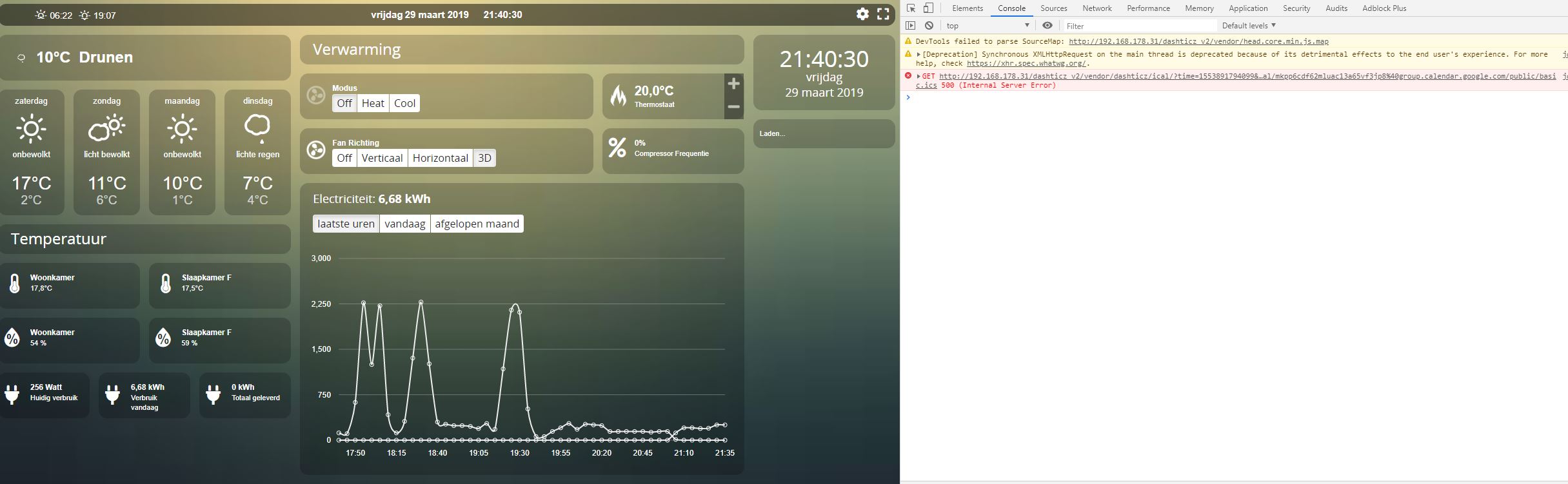

@Lokonli, hopefully you can help me as well with my calender problem.
Information: Dashticz Beta V2.5.10, PHP Version 7.0.33-0+deb9u1
The code in my config.js:
var calendars = {}
calendars.test = { maxitems: 5, url: 'https://calendar.google.com/calendar/em ... FAmsterdam', icalurl: 'https://cors-anywhere.herokuapp.com/htt ... /basic.ics' }
And yes, it has some test appointments in it. Any clue?
var calendars = {}
- Calender.JPG (158.79 KiB) Viewed 3752 times
Lokonli
- Posts: 2292
Re: Dashticz - Module - Calendar
First try without adding cors-anywhere.herokuapp.com to the icalurl parameter.aeonfast wrote: Friday 29 March 2019 21:43 @Lokonli, hopefully you can help me as well with my calender problem.

aeonfast

Lokonli
- Posts: 2292
On my system your calendar is working. I see your three appointments:
var calendars = {}
calendars.test = {
icalurl: 'https://calendar.google.com/calendar/ical/mkpp6cdf62mluac13a65vf3jp8%40group.calendar.google.com/public/basic.ics'
If you still have issues:
Test 1:
are you running Apache?
Look for errors in the Apache log. Normally it's /var/log/apache2/error.log
Test 2:
In chrome, press F12 to open the developers window.
Refresh Dashticz.
Go to the network tab of the developers window. If you type 'ical' in the search field, then you should see the network requests to your calendar.
What is the status?
If you click on the request: Do you see anything on 'preview'-tab? and on the response-tab?
Lokonli
- Posts: 2292
Sorry, I only just see your error message.Lokonli wrote: Friday 29 March 2019 23:03On my system your calendar is working. I see your three appointments:
Don't add cors-anywhere. Please double check that you tested without cors-anywhere.Code: Select all
var calendars = {} calendars.test = { icalurl: 'https://calendar.google.com/calendar/ical/mkpp6cdf62mluac13a65vf3jp8%40group.calendar.google.com/public/basic.ics' }
Test 1:
Test 2:
Refresh Dashticz.
What is the status?
Probably PHP reported an error. Test 1 (see above) should give a clue.
aeonfast
- Posts: 7
- Joined: Friday 29 March 2019 16:16
Okey, I double checked again for cors and deleted a couple in my config.js. Used the search function to delete them all. Still nothing happens and the same error stays.
I checked the error.log in the apache folder and it's empty.
I openened the developers window, and I see the network request to my calender. It says: this request has no response data available. If I try the complete link myself in the browser it says: 192.168.xxx.xxxx can't process this request.
Public link works fine. I ran the PHP installations once more, but they were all good.
sudo apt-get install php
sudo apt-get install php-xml php-curl
EDIT: I rebooted my Pi, and now it says: VM1426:5 Domoticz error!
Calendar requires a PHP enabled web server.
PHP not installed.
VM1414:685 PHP not enabled and default_cors_url not set.
VM1414:686 CORS proxy: https://cors-anywhere.herokuapp.com/
I'm completely lost now lol. Error log stills shows nothing.
PHP not installed.
Lokonli
- Posts: 2292
Did you restart apache?aeonfast wrote: Friday 29 March 2019 23:23 Okey, I double checked again for cors and deleted a couple in my config.js. Used the search function to delete them all. Still nothing happens and the same error stays.
You copied the php version from the Dashticz->settings->info-tab? Because that would mean that PHP is working.
In the network request in the develop window you can see the url parameter. Can you try to open this url in a browser window? You should get a file-save dialog with an ics file.
Lokonli
- Posts: 2292
ok, then PHP can not be found by Dashticz, and calendar won't work.aeonfast wrote: Friday 29 March 2019 23:23 Okey, I double checked again for cors and deleted a couple in my config.js. Used the search function to delete them all. Still nothing happens and the same error stays.
PHP not installed.
In some systems there where issues with permissions.
They can be set correctly with:
chmod -R a+rX /home/pi/dashticz_v2-
aeonfast
- Posts: 7
It finally works!
I think 'sudo apt-get install php libapache2-mod-php -y' did the trick. PHP is enabled and working properly now it seems.
Thank you for your time! I can now sleep peacefully

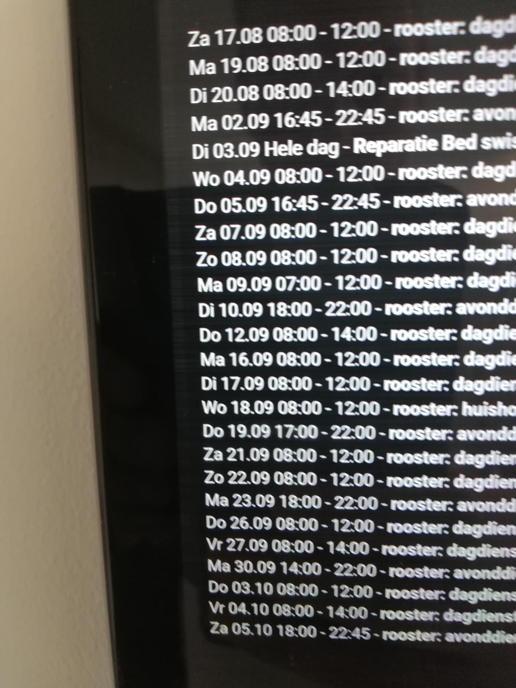

is there a way to get the text in the agenda aligned, so times aligned, agenda item aligned?
Lokonli
- Posts: 2292
No, currently not. I'll add it to the feature request list.
