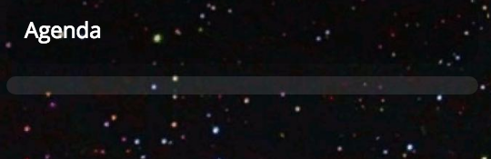

Still can't get it to work.
var calendars = {}
calendars.business = { url: 'https://calendar.google.com/calendar/', icalurl: 'path_to_basic.ics' }
calendars.private = { icalurl: 'path_to/basic.ics' }
calendars.combined = {}
calendars.combined.calendars = [
{ color:'white',calendar:calendars.business },
{ color:'red',calendar:calendars.private }
calendars.combined.url = 'https://calendar.google.com/calendar';
I can see a place under 'Agenda' a slightly lighter place where there should be something, but when clicking it's empty. I think it because of the 'calendars.combined.url'. What should be there?
Agenda
Agenda
Screen Shot 2017-05-08 at 13.31.00.png (128.97 KiB) Viewed 15224 times
bsmeding
Posts: 34
Joined: Tuesday 28 October 2014 18:29
Re: Dashticz - Module - Calendar
Post by bsmeding »
robgeerts wrote:
bsmeding wrote:Yes me too, now whole day or repeating items.
Also still a problem with the timezone, everything is +2 hour, is there a possibility to change the timezone
I'm using iCloud calendar
Could you try latest BETA?
I'm not sure but I changed one thing that may fix it...
I checked latest beta, but still a 2 hour offset
bsmeding
Posts: 34
Post by bsmeding »
EdKo66 wrote:Still can't get it to work.
var calendars = {}
the block must have the value 'calendars.combined' {without the .url}
columns[2]['blocks'] = [314,315,399,''blocktitle_14',calendars.combined]

That is what I have. Maybe I do something wrong with the Google Calendar. Trying with Icloud.
