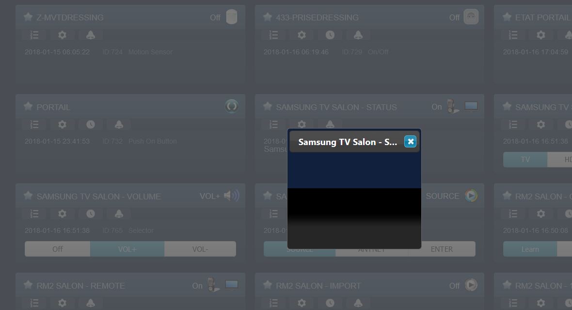

Post by zak45 »
blauwebuis wrote: Tuesday 16 January 2018 12:41 QUESTIONS
- how are remote control popups now? The grey issue is hopefully fixed.
So .. not so good:

Post by zak45 »
Remote control still the same :-(

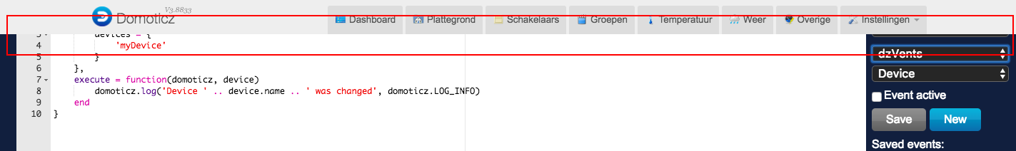

htilburgs
Posts: 464
Aurora theme - Events page
Post by htilburgs »
Nice to see that the theme is published and making a lot of progress.
I've an issue with the events page. I don't like the main menu or the settings menu as a sidebar, so I switched this option off.
When I go to my Events page, to create or edit events, the top part of the screen is 'hidden' under the main menu.
Can this be corrected?
