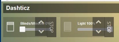

I do have a few 'rolluiken' with a fibaro shutter unit. These blinds have a percentage bar in domoticz but in dashticz they show with an up/down/stop button. This does not seem to work (the stop does not stop it). Is there a way to give it a percentage bar in dashticz? Like dimmer lighting?

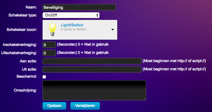

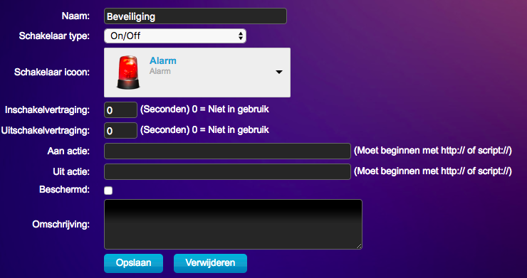

I don't know if it's a bug, but I've the next issue:
- Create a DummySwitch - Type On/Off Switch
- I can switch it from Dashticz
- Change Switch Icon from "Light/Switch (BULB)" to "Alarm"
- It cannot be longer switched from Dashticz (like protected = true)
Schermafbeelding 2018-01-10 om 17.33.18.png (157.66 KiB) Viewed 9480 times
Schermafbeelding 2018-01-10 om 17.33.31.png (154.32 KiB) Viewed 9480 times
Hardware:

Moosjes wrote: Wednesday 10 January 2018 16:11 I do have a few 'rolluiken' with a fibaro shutter unit. These blinds have a percentage bar in domoticz but in dashticz they show with an up/down/stop button. This does not seem to work (the stop does not stop it). Is there a way to give it a percentage bar in dashticz? Like dimmer lighting?
Thanks for your message. Can you tell me what the relevant part of http://{domoticzIP}:8080/json.htm?type=devices for the blinds looks like? There should be a percentage bar if the blinds have that option.
I also see that the stop action does not work, but in Domoticz itself the stop button also does not work (and only shows up for 'Venetian blinds')

htilburgs wrote: Wednesday 10 January 2018 17:36 I don't know if it's a bug, but I've the next issue:
I cannot reproduce this issue (the switch is only disable if I set it to protected in domoticz).
Contributor to Dashticz
More on my Github profile

aiolos wrote: Wednesday 10 January 2018 18:59
Strange thing. I can select everything it still works as an on/off switch in Dashticz. Only when I select the Alarm icon, the on/off function in Dashticz is gone.
Icon type "Alarm"
Schermafbeelding 2018-01-12 om 20.20.07.png (44.42 KiB) Viewed 9437 times
Icon type "Switch or other than Alarm"
Schermafbeelding 2018-01-12 om 20.19.38.png (45.42 KiB) Viewed 9437 times

Bug fix request:
Blinds Percentage - common problem in current Domoticz release.
Created in default dashboard Blind percentage (via My sensors USB Gateway) slide doesnt work (not possible to move it) open / close are ok
The Light (used for the same node) - slide works ok I can set e.g.25% of blind level, but unfortunately buttons are not sending the proper msg (as blinds).
So the perfect combination would be to combine both widgets
When both widgets are transferred to Dashticz:
It appears to be the same like on the pervious screen but not exactly:
Blinds: Up/Down buttons work ok , Stop (wasnt on default Domoticz dashboard) here appears and works ok. Slide(cannot move it to e.g.34% but as you press the buttons open/close it jumps from 0 to 100%)
Light (as described above) - no change
I'am not a coder hence my question: Is Dashticz just a layer or there is possibility of separate communication with e.g arduino node.
Just asking because - many people is waiting for Domoticz to be fixed with blinds percentage - Maybe Dashticz is our hope ....
Icon type "Alarm"
Do you have any custom javascript that can remove something? What if you have an almost empty CONFIG.js (only the bare minimum) and not custom css or js. (On my local machine I only see this behaviour if I make the switch protected)

plantex wrote: Saturday 13 January 2018 1:23 Hello.
Great Job - Thanks for Dashticz.
Bug fix request:
Plantex
In fact Dashticz is just another layer as dashboard against domoticz backend. There are some extra things like the garbage, news and music player modules.
It is interesting to see what is exactly wrong with the blinds. Recently some small changes have been made because of some errors in displaying the blinds and I noticed that the whole stop command on domoticz is also not doing anything (the response of the API is an error), so I'm also wondering what kind of blinds you have where this works (so I can try that on my local machine too).
If there is something wrong in the domoticz backend, then dashticz cannot change that.
I will have a look at the percentage behaviour, but I don't have any blinds myself, so it is playing around with dummy switches.
