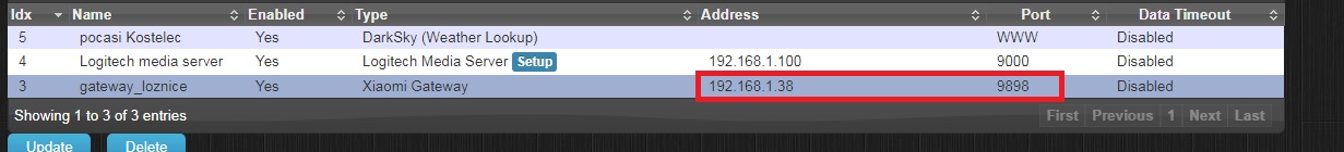

can anybody help me, please? I've installed and configured xiaomi gateway. Everything works great. Blockly events works.
Now I'ld like to set light color. This can be done by json script. But if I try it from OS I get this response:
d:\curl\src>curl -S -i -H "Accept: application/json" "http://192.168.1.38:8080/json.htm?type=command&param=setcolbrightnessvalue&idx=12&hue=38&brightness=83&ishite=false"
curl: (7) Failed to connect to 192.168.1.38 port 8080: Connection refused
d:\curl\src>curl -S -i -H "Accept: application/json" "http://192.168.1.38:9898/json.htm?type=command&param=setcolbrightnessvalue&idx=12&hue=38&brightness=83&ishite=false"
curl: (7) Failed to connect to 192.168.1.38 port 9898: Connection refused
Why I get this error? IP adress is OK. (I've tried two ports)
hekm77
Posts: 45
Joined: Thursday 09 February 2017 18:31
Post by hekm77 »
serak wrote: Wednesday 27 December 2017 0:34 Why I get this error?
IP:Port = ip_domoticz:port_domoticz
idx = xiaomi gateway idx from devices tab
serak
Joined: Friday 15 December 2017 11:51
Domoticz version: 2024.7
Post by serak »
It works! Thank you.
