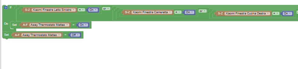

is this correct
this is sensor for door/windows
if door is open netatmo go to away
else in on
