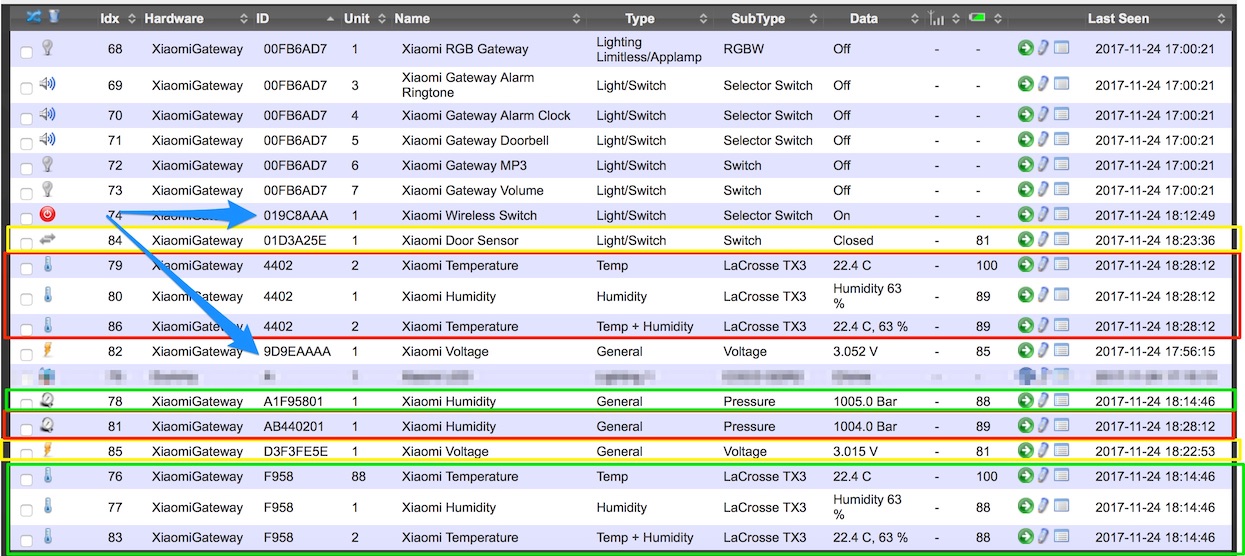

One interesting thing that battery for Temp is 100, Temp+Humidity is 89. Which is real and why is there two different value?
I grouped devices together. It's very hard to pair for example Voltage with it's corresponding device. The ID is different. Also pressure is indicated as separate device, but there is now a Temp+Hum+Baro device in Domoticz.
How often are temperature devices updated? It is not possible to set a 5 minute interval?

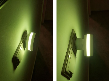

However with tha adapter price tag of around 10 euro's .... the Neo Cool Smartplug Can compete with it as well priced at € 16- €20 euro's
At least it will plug the Gateway much nicer against the wall I think.
Last year found these, ive installed 6 of them and working since Jan. Very flat and way cheaper (with shipping around $2 a piece)
https://www.ebay.com/itm/EU-3-Round-Pin ... 1737610742
Nice fit :D
Many thanks for the tip.

About the battery statuses not updating anymore: Corbin told me it's not on purpose and he will probably have a look at it this weekend. Hope this will be fixed real soon :)

Corbin directed me in the right direction: the battery statuses have changed a while ago. When you add a User Variable with the name 'XiaomiVoltage' (integer / 0), and restart the Xiaomi hardware, the statuses re-appear :) Thanks, Corbin !
Edit:
Now I'd like to use the right names for the battery statuses, how can I see which device it belongs to? I can partially combine by using the battery status (for instance: 795 is unique, and could be the "Garagedeur (X)"), but there are more than 1 with 83%, so: how ??
  	4596	Xiaomi GW	191B1B13	1	Xiaomi Voltage	General	Voltage	3.035 V	-	83	Add DeviceRename Device Log	2017-12-02 16:45:29

mvveelen wrote: Saturday 02 December 2017 11:30 Corbin directed me in the right direction: the battery statuses have changed a while ago. When you add a User Variable with the name 'XiaomiVoltage' (integer / 0), and restart the Xiaomi hardware, the statuses re-appear :) Thanks, Corbin !
Maybe add this to the Xiaomi gateway wiki page?
I was also struggling with this.
And with restart Xiaomi hardware, he means not the gateway itself but disable/enable Xiaomi hardware in Domoticz :-)
