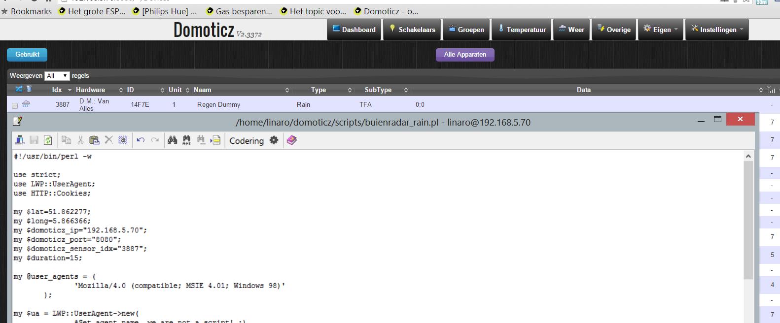

I saw a buienradar_rain script when I was logged in with FTP.
I have adjusted the data.
I have a dummy rain sensor.
But now?
I need a crontab?
What does this sensor?
What else can I set?

linaro@cubie:~$ sudo perl /home/linaro/domoticz/scripts/buienradar_rain.pl
OK, precip=0.00
#!/usr/bin/perl -w
use strict;
use LWP::UserAgent;
use HTTP::Cookies;
my $lat=50.22041;
my $long=5.89744;
my $domoticz_ip="192.168.5.70";
my $domoticz_port="8080";
my $domoticz_sensor_idx="3904";
my $duration=15;
my @user_agents = (
		'Mozilla/4.0 (compatible; MSIE 4.01; Windows 98)'

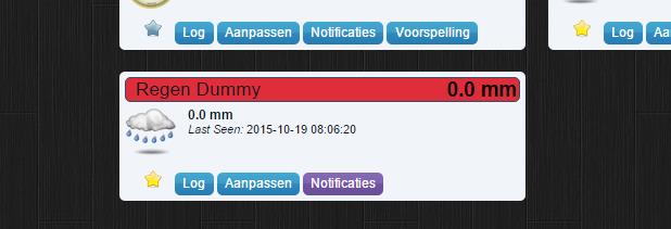

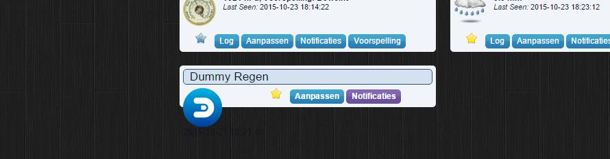

Only it is killing my dummy rain sensor:

You have to use a percentage sensor

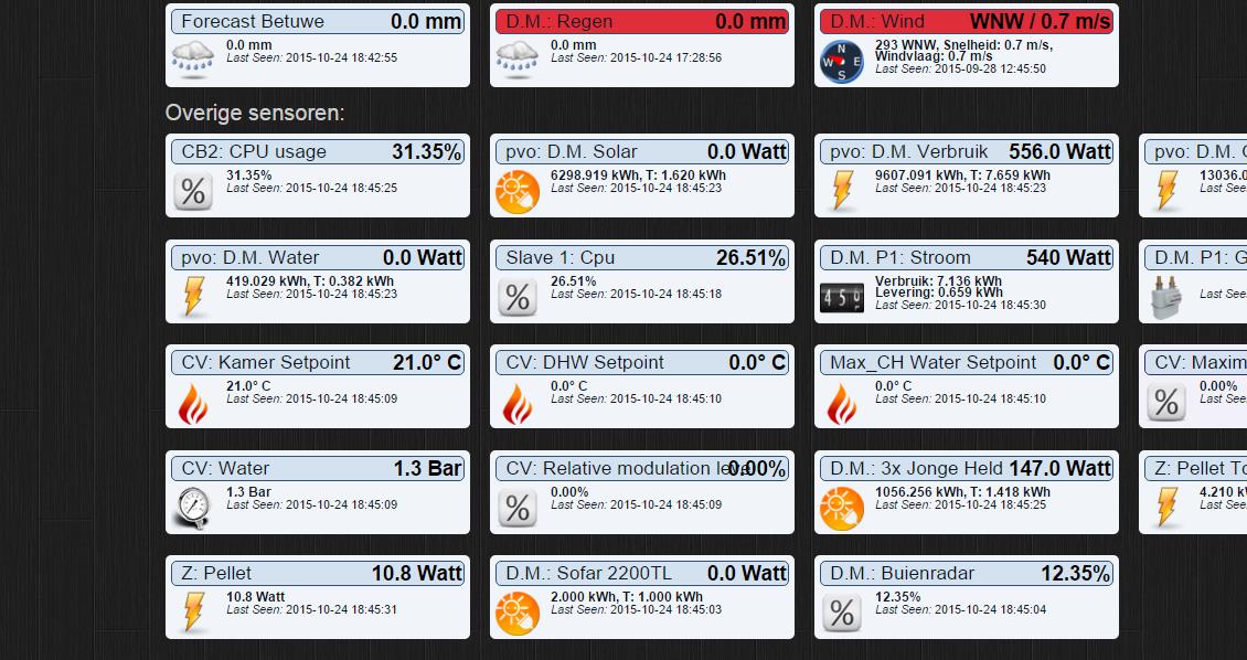

And the higher the percentage, the more chance of rain?
Too bad he is not active weather sensors. ;)
gizmocuz
Posts: 2709
Location: Top of the world
Re: Buienradar settings
Post by gizmocuz »
correct, 20-30 is a good change, best to look outside when it is raining, and check the percentage

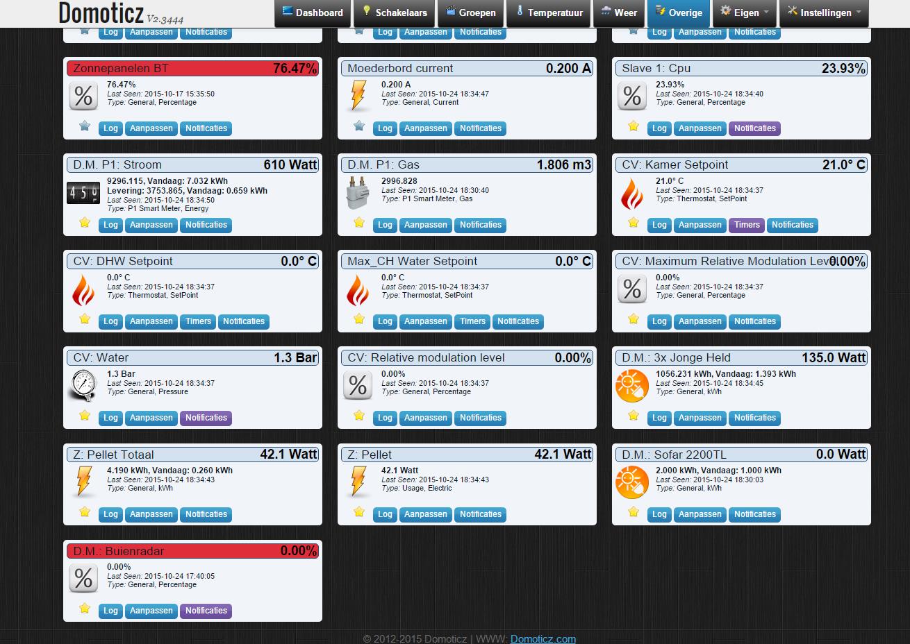

Update problem...
After the last update a red device....
I try:
Error sending data to domoticz!
So it is not working any more..
I make no changes....
Are there more problems?

Did 20 minutes ago the update...
After that the % device is red..
Perhaps there are more people with a problem was what i mean..
Derik
Posts: 1605
Post by Derik »
Found it...!!!
The update make the settings in the document back to standard....
my idx was changed and the domoticz ip was chagend to..
Changed them back:
So it is working again....
