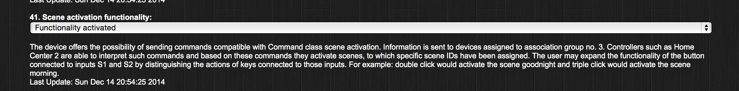

I have a FGD211Fibaro dimmer module and would like to attach a scene to the triple click functionality. In domoticz I can enable the functionality in the hardware settings but what I make out from the description it is not possible in Domoticz (see attachment)?

Any idea if it is possible to attach a scene to the triple click functionality? Or is it not implemented yet?

Later on I found an unknown device in my device list. After some investigation I found out that it was a new switch created after I enabled the scene activation in the settings of my Fibaro dimmer (FGD211 micromodule).
I added it to the switch page, gave a it a proper name and attached a scene to it.
Now I can triple click my (physical) switch to turn of all lights before I go to bed:-).
I hope it helps someone having the same question I had.
