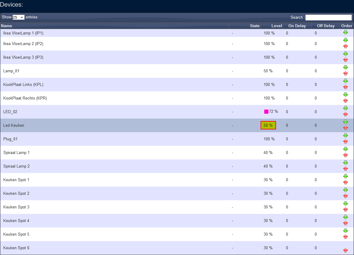

I have setup a group within Domoticz which called "All". This group has several devices defined, one called "Led Keuken". Within a dzVents script I would like to ask what level I setup for this device.
2024-04-07 12_43_55-Clipboard.png (48.44 KiB) Viewed 870 times
Is this possible to do? and if so, has some one a sample cond for me?

sometimes you have to look twice. could reas the setting with
local myDevice = domoticz.groups('All').devices().find(function(device)
	return device.name == 'Led Keuken'
	end)
domoticz.log('Level is set to: ' .. myDevice.level)
