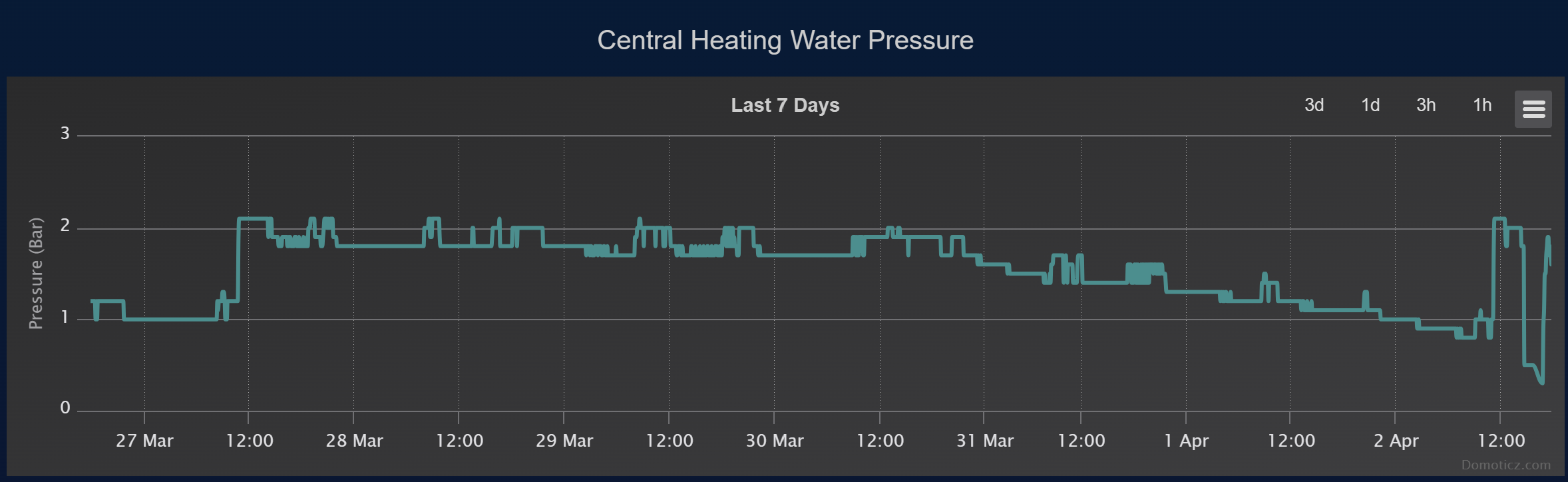

One of the most useful features I have installed in Domoticz: an e-mail alert when the water pressure in my central heating becomes too low.
After filling up the system last week, I got an alert this morning. Turns out the pressure dropped from 1.8 to 1.0 in 2 days.....leak has now been fixed.
The spikes at the end of the graph is me filling up the system, locating the leak and fixing it.
