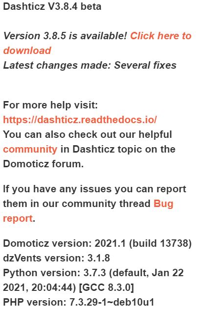

What is your Dashticz version? and PHP version?Bospieper wrote: Friday 22 October 2021 9:29 Hello,
When I have a repeating appointment, for example every 5 weeks, the appointment appears every week in the calendar.
Has anyone experience this behaviour?
Grtz Piet
(this influences which calendar module is used by Dashticz ...)

Re: Calendar: issue with repeating appointments
@Lokonli see the attachment
- Dashticz.JPG (52.47 KiB) Viewed 511 times
Lokonli
- Posts: 2292
ok, thanks. I'll have a look.
