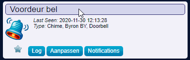

florfilla19 wrote: Tuesday 01 December 2020 21:39 Email sending is already configured and works well
2020-12-01 15:42:57.447 (RFLink433) Light/Switch (DoorBell)
If you goto the switches tab and press [Notifications] on the DoorBell device, you get a new page like below
set the values as per the above screen and press press [Add] The next time the device is activated you should receive an Email.

This setup is working well here. But I'm using telegram and did not select the ignore interval.
In my opinion Telegram is more faster and reliable then a message by mail.

florfilla19 wrote: Friday 04 December 2020 9:15 Under switches 'Doorbell Status is stop'
Mine is type Doorbell
I use dzVents to send a message with picture, default to Telegram. Email is to slow.
Rest of settings is as yours.

Switchtype is doorbell here.

Finnaly we made it ! Thanks all for your help.
So the clue was switching to DoorBell rather than Light Switch and creating a second Alert for Switch On or Off.
Don't remember which one it was.
