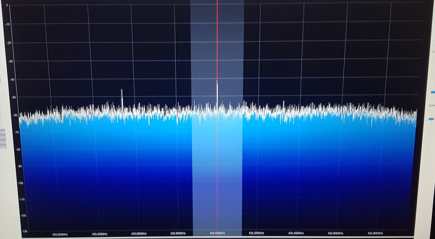

I checked with a spectrum analyzer, will show you the results:
indeed, 433..
but, its weird that the rfxcom as well the rflink didnt see this doorbell?

doorbell pressed:
normal:

BarryT wrote: Wednesday 17 April 2019 19:47 but, its weird that the rfxcom as well the rflink didnt see this doorbell?
why is that?
doorbell pressed:
Then it probably is not supported, did you check the supported device list of both transceivers?

It seems that it is fsk modulation, a protocol wich is not supported by rfx or rflink..
Need to have an arduino with rfm69 chip.
