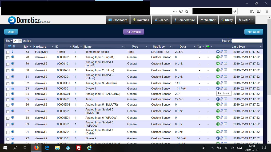

it looks like this.. and i use denkovi daenetip4 hardware
Screenshot (17).png (373.66 KiB) Viewed 3908 times
Re: Utility value to dummy percentage
Tarzan737 wrote: Tuesday 19 February 2019 17:26 it looks like this.. and i use denkovi daenetip4 hardware
In this deviceType the value is stored in the sValue field. Can you test below script ?
