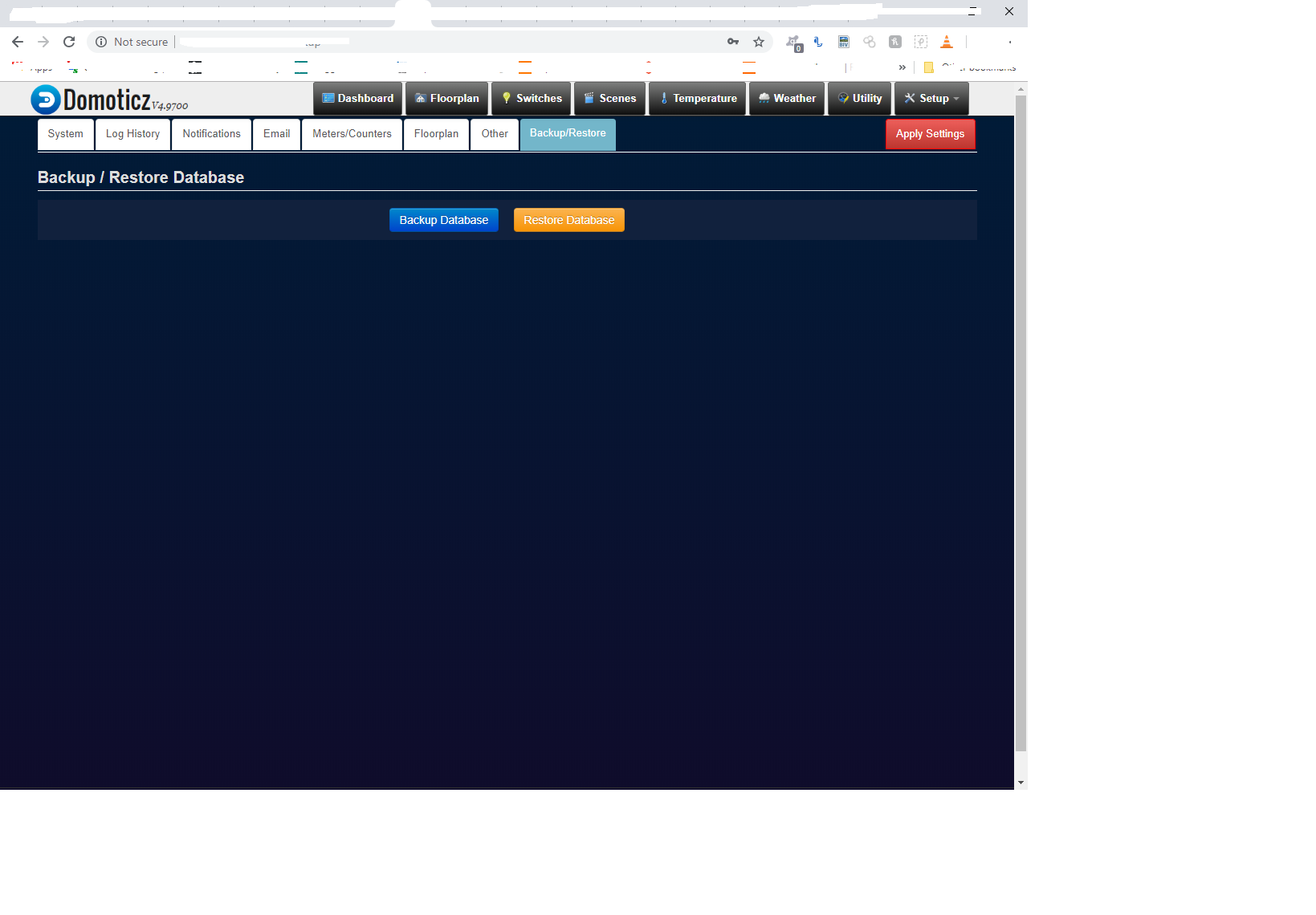

Normally I just use this screen (Pic attached)
Will this be sufficient or do I need to do more.

This will only make a backup of your database. Very important but not enough for what you want to do. You will miss external scripts / plugins and some zwave stuff from the config subdirectory. I don't know exactly what you need from that, i normally just copy everything when I create a clone on my test system.alarm_guy1 wrote: Thursday 24 January 2019 9:08 Normally I just use this screen (Pic attached)
