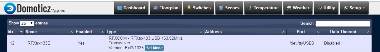

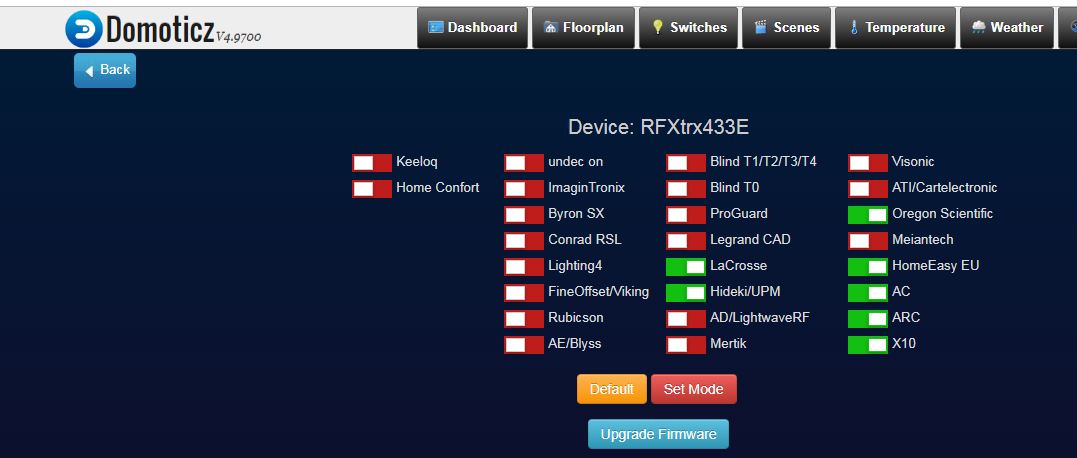

Due to a SD crash issue on my previus installation ( I had running 3.8153 stable version)- I have done a new installation on last domoticz stable version, however when I tried to setup RFXtrx433E for my Somfy awning I seen Somfy support has gone
Do you know somebody how to support again Somfy devices ?
Thank you very much for your support

Somfy RTS is not received and no need to enable a protocol for this.
Manually create the Somfy RFY devices on the Switches tab.
Use RFXmngr to know the ID and unit numbers you have used. On the RFY tab transmit a "List Remotes" command.
