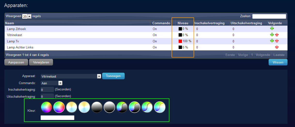

yfands
Posts: 67
Joined: Monday 04 July 2016 10:16
Domoticz version: latest B
Re: dZvents broken with 3.9165
Post by yfands »
Version: 3.9174 beta
Build Hash: ac7daa5b
Compile Date: 2018-04-03 12:59:46
dzVents Version: 2.4.2
Also my scene's with milights, all my lights turn red and I can't change them back, what's with the colored circles and txtbox ????
See picture. The orange box shows that all my lights are red after the latest update, tried to change them via the colored circles but all I ended
up was a black square and 0% luminosity. How do I reverse this with this o so not-friendly totally not understandable (sorry) circles interface.
It's not responding to my mouse clicks or value that I put in the txtBox, is there a manual how to operate this????
Frank

yfands wrote: Wednesday 04 April 2018 23:43 Version: 3.9174 beta
Frank
But thats not dZvents problem, i saw some patches on github so maybe fix is allready prepared.. :)
yfands
Posts: 67
Post by yfands »
Hai devros,
Yup, you are right no dZvents. I was referring to the RGB issues maybe a common 'module' error.
Thanks, I will give github a try..
