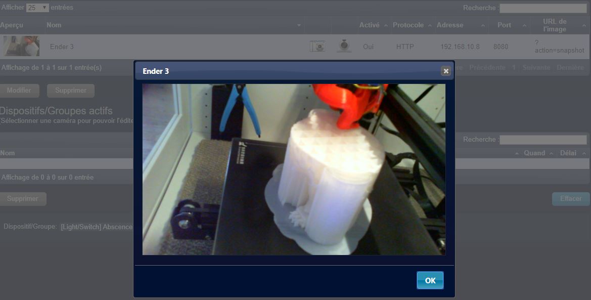

I known it's an old thread but i find the solution
you must set :
in ip address the ip of octoprint: 192.168.X.X
in port: 8080
in image url: ?action=snapshot
(user and password no needed)
you must set :
in port: 8080

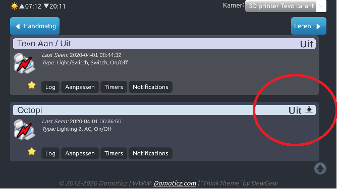

This is how i did it.
I created a camera in Domoticz, Protocol set to HTTP, Address is IP of Octoprint, Port is 8080, ImageURL is ?action=snapshot
Then connect this camera to a lightswitch, in my case the keep-alive (ping) of octoprint.
Below a picture of how it looks.
The other switch you see is the real on/off switch.
- octo.png (47.49 KiB) Viewed 1643 times

Re: Cam from RPI running Octoprint wont work
Thks, it solved my problemaxel2906 wrote: Saturday 17 August 2019 9:17 I known it's an old thread but i find the solution
you must set :
in port: 8080
