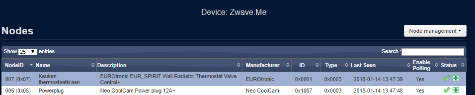

Nodes:
Eurotronic Spirit Nodes

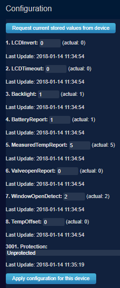

Configuration:
Eurotronic Spirit Configuration

        <!-- Configuration Parameter -->
        <CommandClass id="112">
                <Value type="byte" genre="config" index="1" label="LCDInvert" units="" value="0"/>
                <Value type="byte" genre="config" index="2" label="LCDTimeout" units="" value="0"/>
                <Value type="byte" genre="config" index="3" label="Backlight" units="" value="1"/>
                <Value type="byte" genre="config" index="4" label="BatteryReport" units="" value="1"/>
                <Value type="byte" genre="config" index="5" label="MeasuredTempReport" units="" value="5"/>
                <Value type="byte" genre="config" index="6" label="ValveopenReport" units="" value="0"/>
                <Value type="byte" genre="config" index="7" label="WindowOpenDetect" units="" value="2"/>
                <Value type="byte" genre="config" index="8" label="TempOffset" units="" value="0"/>
        </CommandClass>

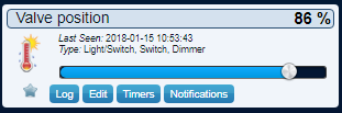

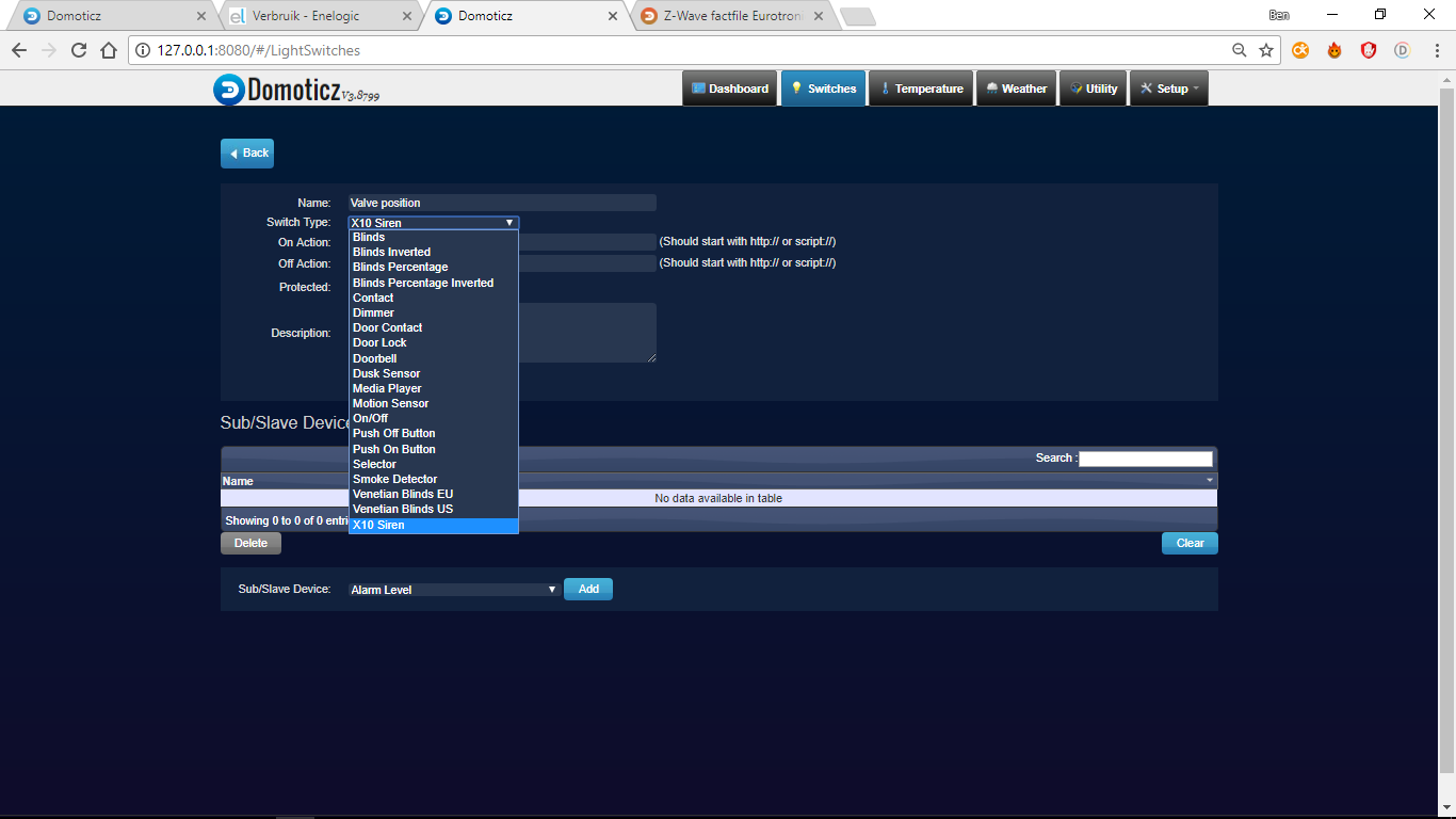

The settings in Domoticz needs more fine tuning.
The HVAC/Thermostat is seen as a light/switch, switch, dimmer.
Eurotronic Spirit valve position
Eurotronic Spirit valve position 86%
I already changed the pictogram, it was shown as a bulb.
The are blinds, dimmer, doorbell, doorlock, doorswitch, sirene, nothing about heating that fits the need.
Different switch types

Thank you for the XML File ,
but there is a problem with the temperature offset setting. If you set the offset to a value below 0 the value is not set.
I bought the valve to use it as an alternative to the danfoss lc-13 , because of the missing offset setting.
If you have a radiator built in a wooden cabinet you get wrong temperature values from the controller because of the hot spot near the sensor.
So the offset value is pretty important to me.
Addtional there is no possibility to set the target temp as a device like the lc-13 , is this a xml setting ?
Wolfgang
Posts: 22
Joined: Saturday 28 October 2017 21:37
Re: Z-Wave factfile Eurotronic Spirit Z-Wave+ radiator thermostat controller
Post by Wolfgang »
... found a solution ...
setting the value to 215 ( 255 - 40 = -4.0 degrees Offset ) is corresponding to the negative offset

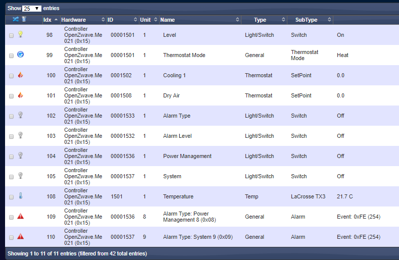

The file ZC10,,,, is a product data file, explaining several specs of the controller.
You can you the information as a guideline to make the eur_spirit.xml, but I haven't used it in Domoticz.
I don't control the thermostat at this moment.
Can't help you with all the options.
Eurotronic Spirit devices
Devices overview Eurotronic Spirit

Am i missing something - which of the 11 switches allows me to set the temp setpoint?

The Dry Air Temp is de heating setpoint.

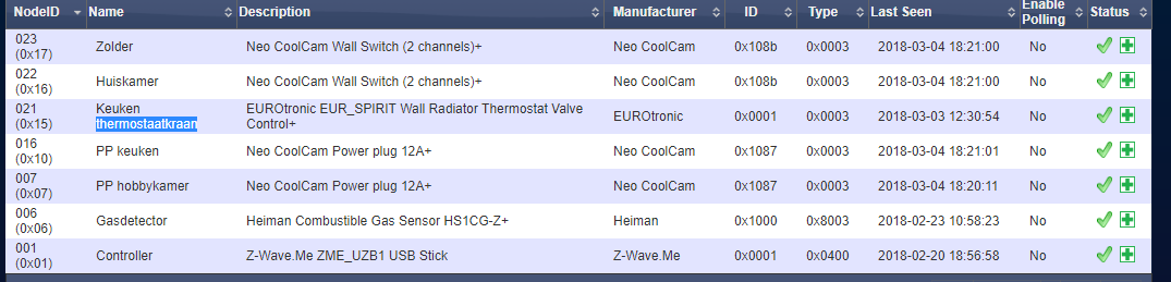

I'm still a beginner. Installed my Zwave.me USB stick and Domoticz on my Synology NAS DS214... Placed under the roof of my 3 story house I have often dead node(s) in the network. Also the Eurotronic Spirit heatvalve in the kitchenette downstairs is sometimes a dead node.
Now I installed the NAS on the ground floor in a cabinet and I loose the node(s) upstairs. Keeps me busy with problem before I go any further with home automation.
As repeaters I use 2x Neocam powerplug and a Heiman gasdetector HS1CG-Z on 220v, on the different stocks, but still dead nodes.
In the settings of Domoticz in the Zwave.me controller is the option
""Enable Nightly Heal Network 04:00u"
Never seen that it repaired (Heal) the network, I have it enabled, but there is no result shown (time when finished or so). That is still a mistery for me.

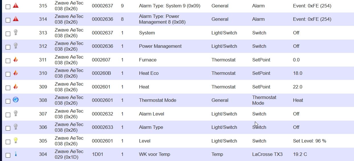

Since Yesterday I have a strange issue with a newly added Eurotrocs Spiritz. I added two which are working perfect (added earlier) and the last two I do not get of a Temp LaCrosse TX3 sensor. I added them in the same way. Does somebody does know this problem?
2018-10-08 22_03_10-Domoticz.png (55.31 KiB) Viewed 11224 times
In the picture you see the last line of the first thermostat and all lines of the last thermostat.
I fixed it!
The only thing I did as far as i can figure out is to use this line in manufacturer_specific.xml:
<Product type="0003" id="0001" name="EUR_SPIRITZ Wall Radiator Thermostat Valve Control" config="eurotronic/eur_spiritz.xml"/>
Instead of this line:
<Product type="0003" id="0003" name="EUR_SPIRITZ Wall Radiator Thermostat Valve Control" config="eurotronic/eur_spiritz.xml"/>
But As far as I can remember I tried it before with the same line.

In Devices there is a lot of new stuff from Eurotronic now.
I assume - Temp LaCrosse TX3 - is showing actual ambient temperature measured (but it is not refreshed, so nothing usable). And one of Eurotronics - Thermostat SetPoint is for controling valve temperature for radiator. Probably this one, which synchronize with display on the valve.
There are some other setpoints for different heating modes, but not sure, how to use this. Also I am not able to see where to set Wake Up interval for this valve. Danfoss LC-13 has this settings.

Just installed this to replace my Popp thermostat which gave me hassle with zwave.
Using the settings in the previous post, the dry air is not the setpoint I can use + the temp sensor only showed up after a reboot. That said, it works fine for me.
