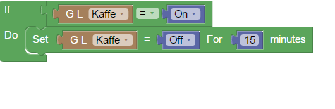

I want the switch to turn of after 15 minutes after it is turend on but it keeps
turning on/off every 15 min instead. What's am I doing wrong? Picture Attached.
- 2017-01-11 15_37_08-Domoticz.png (7.59 KiB) Viewed 4304 times

Shouldn't you be using "Off AFTER 15" instead of FOR.

Re: Switch turns on/off every 15 min.
Try this
If Kaffe = On
Do
Set Kaffe = On For 15 minutes
If Kaffe = On
Do
I think you cannot do that with blocky....
the script will loop all the time....
try LUA instead:
try LUA instead:
if devicechanged['Kaffe'] and otherdevices['Kaffe'] == 'On' then
commandArray['Kaffe'] = 'On FOR 900' -- the FOR instance works in secs
return commandArrayThe most dangerous phrase in any language is:
There is an "Off After X Seconds" block (900 seconds)

Re: RE: Re: Switch turns on/off every 15 min.
Worked a lot betteranasazi wrote:Shouldn't you be using "Off AFTER 15" instead of FOR.
