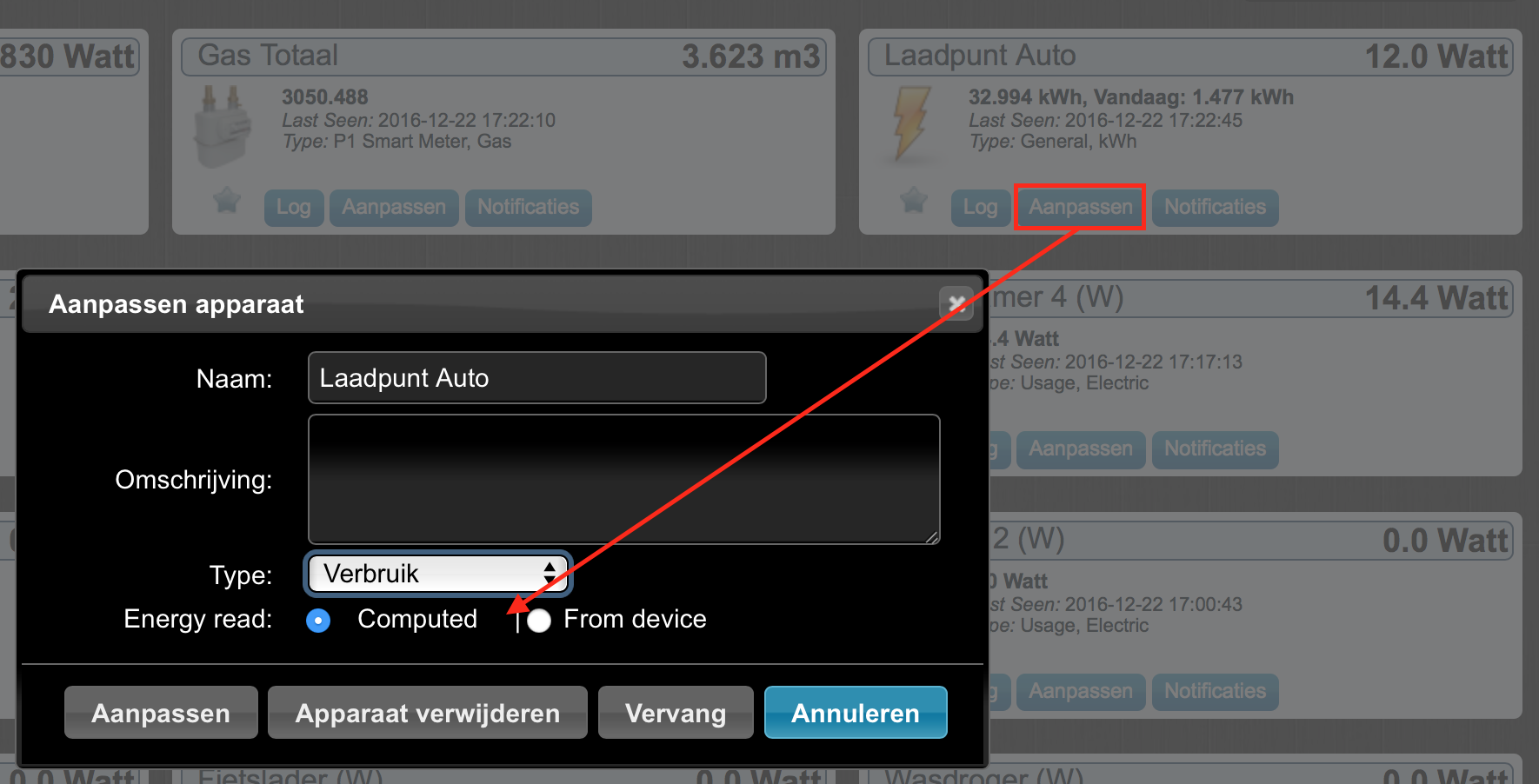

Where do you see those 2 options for energy read?

Check this screenshot;
