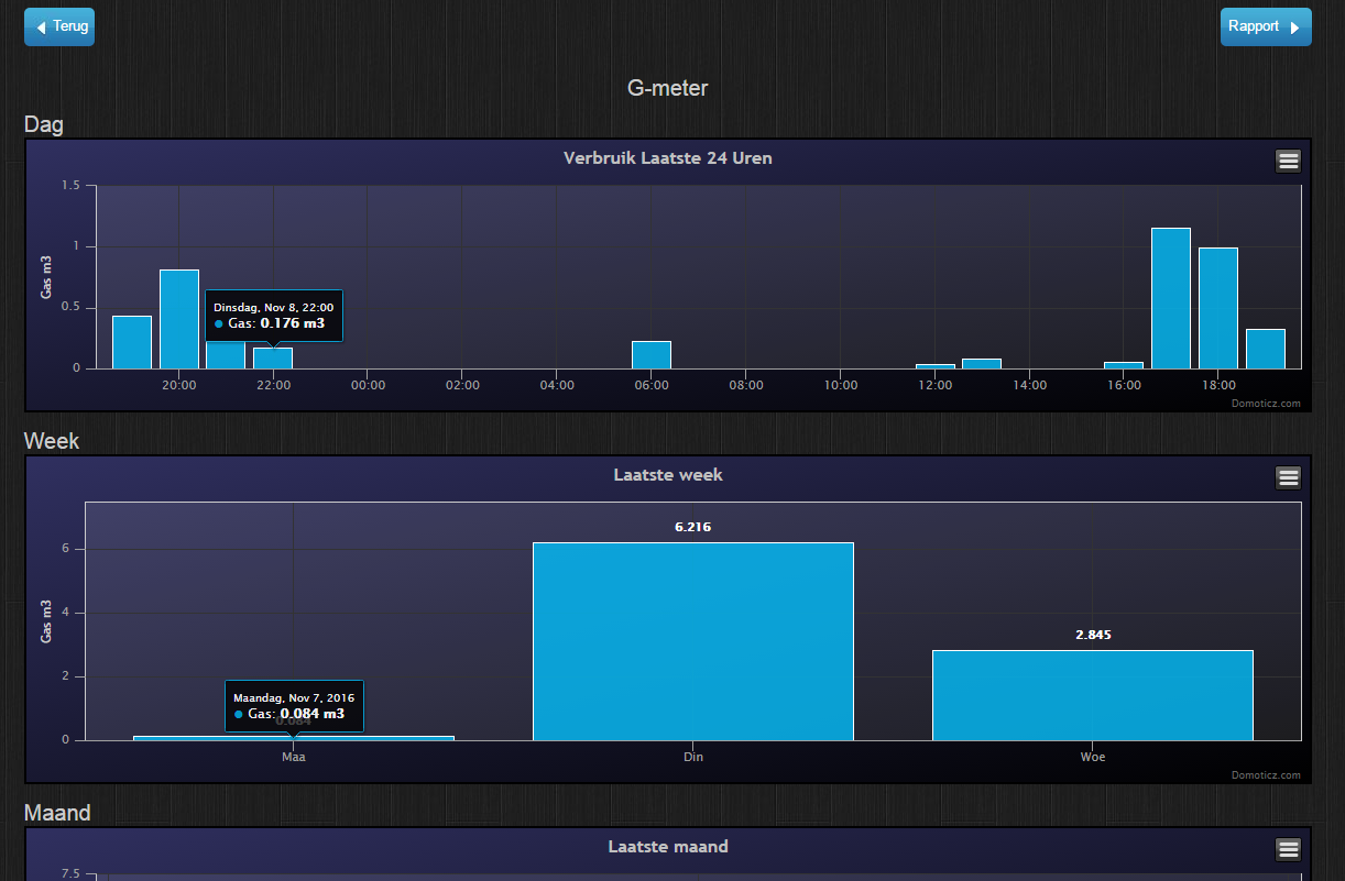

Nope: Chart shows hour values.
See attachment.

Ahh yes... it could be that the chart is displaying in hours, which makes sense, but in your case we might want to see a usage line as for electra
If you export your database, and look into the meter (multimeter) table, i think you will see values with a 5 minute interval

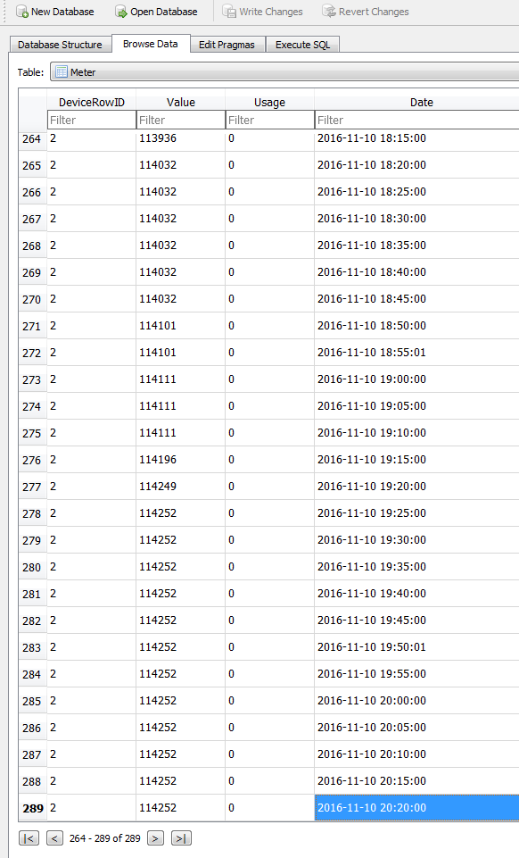

Database will be filled with 5min values. But the Graph will be hourly. What have to be changed to get the 5min graph?
