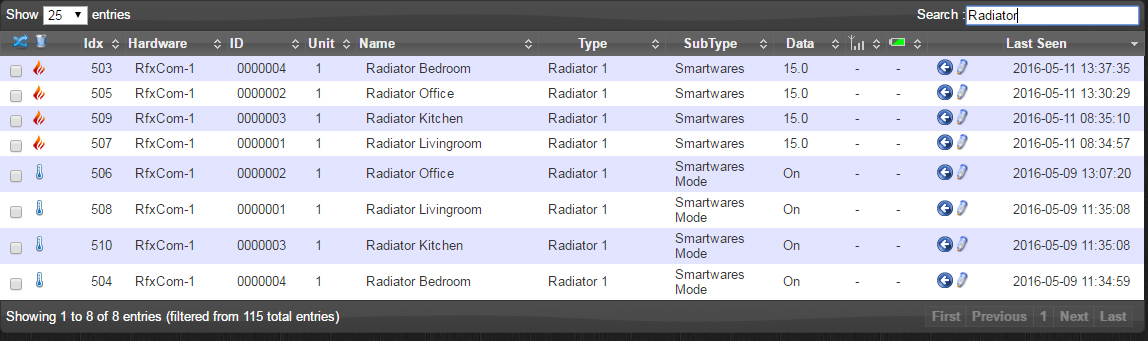

Could you show a screen capture of the devices list and simply put in a filter like "Radiator"?
This will show the existing devices with that name in it and their current values.
r/Jos
r/Jos
DutchHans
- Posts: 230
- Joined: Friday 03 April 2015 20:44
- Location: Germany (near dutch border)
Re: Extracting Setpoint from a Radiatorvalve
Hi Jos,
The complete list of radiators (4 pieces)
- radiators.jpg (263.4 KiB) Viewed 3714 times
