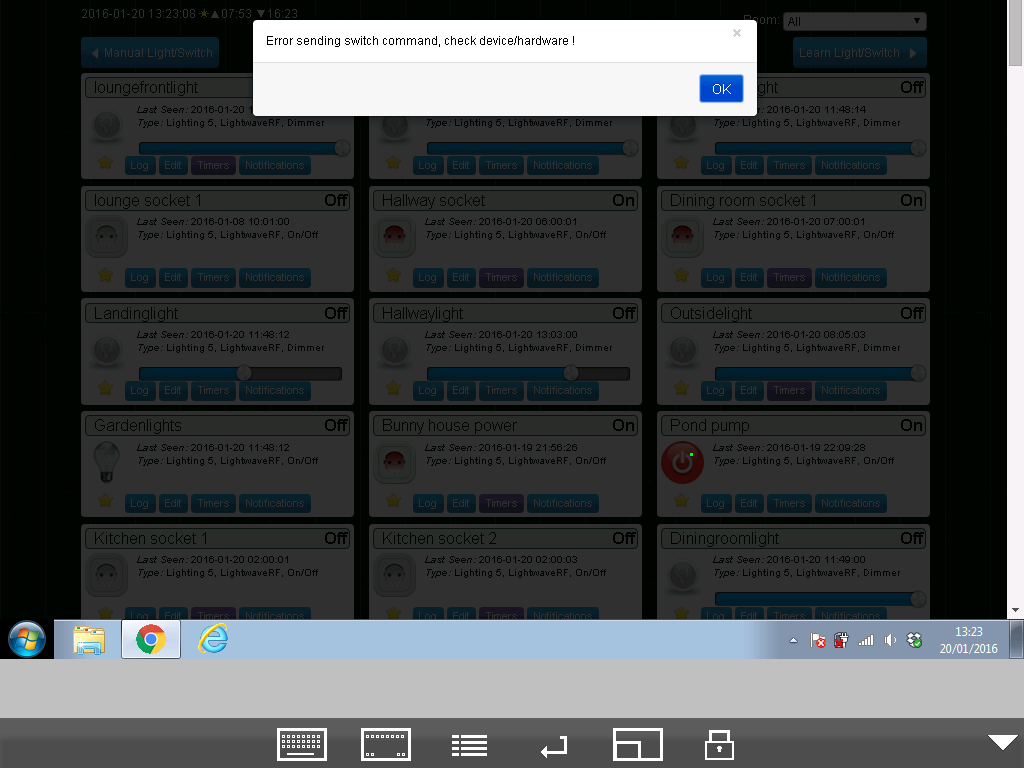

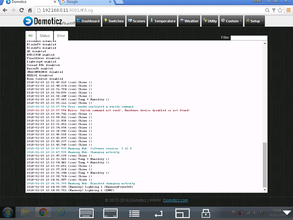

Thanks for your reply.Yes, all the same protocols are enabled but I get the message below. Also, looking at the log, although it receives chimes, harmony hub signals etc, the names are missing from all the "com" switches. It seems all the "com" switches are still lnked to the old RFXcom. I think I need to change something to let the new RFXcom know they exist but I can't figure out how

Did you try restarting your pc? Or at the hardware section, select the rfxcom and press update. Do not remove the device or every device will be removed that uses the rfxcom.

Every switch is connected to a hardware ID in the database. Most easy would be to edit the database and change the ID of the old rfxtrx to the new one. So every switch will work like before.
So lets say your old rfxtrx has ID 3 and your new rfxtrx has ID 6. You edit the new rfxtrx to ID 3, and the old one to 6. Afterwards you can remove the old rfxtrx in domoticz
Edit: Wait, can't you just edit the old device at the hardware tab and change the comport/USB port? You don't need to add a new hardware device, at least not in Linux.

Ha ha, brilliant. that did the trick. I didn't need to add the new hardware at allbizziebis wrote:Every switch is connected to a hardware ID in the database. Most easy would be to edit the database and change the ID of the old rfxtrx to the new one. So every switch will work like before.
