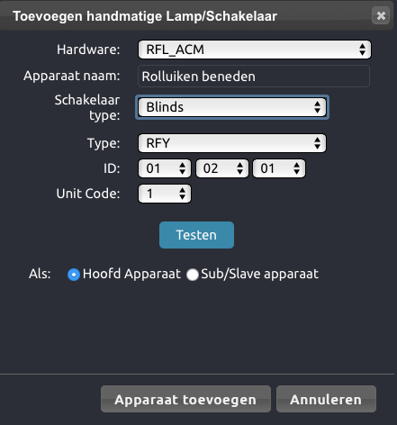

I’ve installed Domoticz (latest/stable)
Added my RF link and is working (tested with some KAKU)
Used :http://www.nemcon.nl/blog2/ with version 39 installed.
Now i’m trying to add my somfy telis 4 remotes to the system.
Added as
check screenshot
Then i’m switching my original remote in learning other remotes
Hit the “testen" button in domotizc
But after that the blinds did not receive the signal (so not able to learn the signal)
I’ve been searching the internet for some days now, but unable to find some information on how to proceed.
Should this work? or am I doing something wrong?
Or do I need to be as close as possible to learn the remote? (now 10 meters)
Hope you can help me a little bit.

- Screen Shot 2016-03-19 at 10.00.14.png (44.68 KiB) Viewed 12680 times
